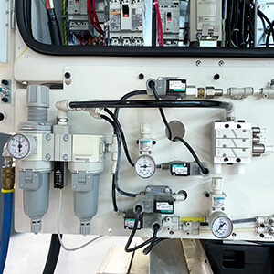

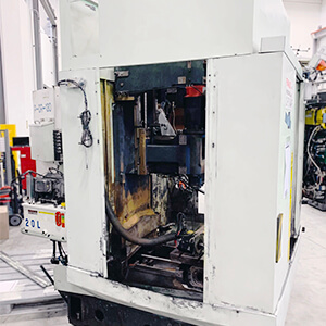

Air Panel Before
Air Panel Before
Air Panel After
Air Panel After

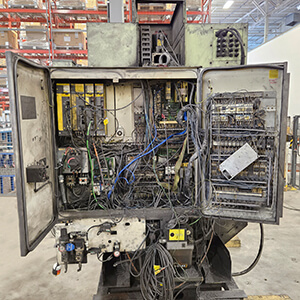

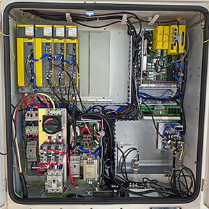

Electrical Cabinet Before
Electrical Cabinet After

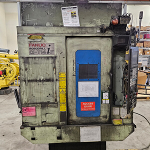

ROBODRILL Before 1
ROBODRILL Before

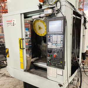

ROBODRILL After 1
ROBODRILL After

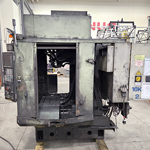

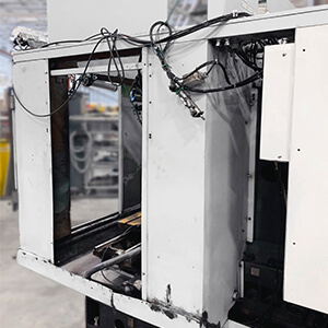

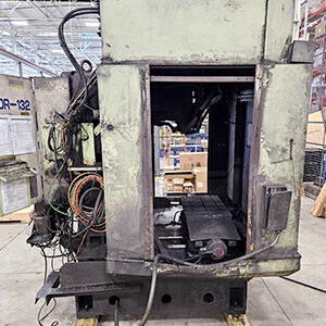

ROBODRILL Before 2
ROBODRILL Before
ROBODRILL After 2
ROBODRILL After

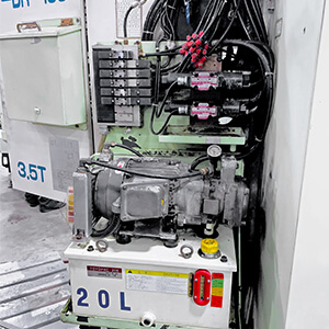

ROBODRILL Before 3
ROBODRILL Before
ROBODRILL After 3
ROBODRILL After
