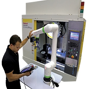

One factor that commonly deters shops from adding automation is the lack of robotics programming expertise. However, cobots are addressing this skills gap issue by allowing robot interaction via a drag-and-drop interface. This way, operators “teach” the arm by physically moving it through each step.
Also, if you have well-versed G-code programmers in your shop, consider adding a control feature like FANUC’s QSSR G-code to help. This allows the robotic motion to be controlled in machine G-code through the FANUC CNC. A teach pendant is only needed for initial set up and jogging, while inside a safety fence.
