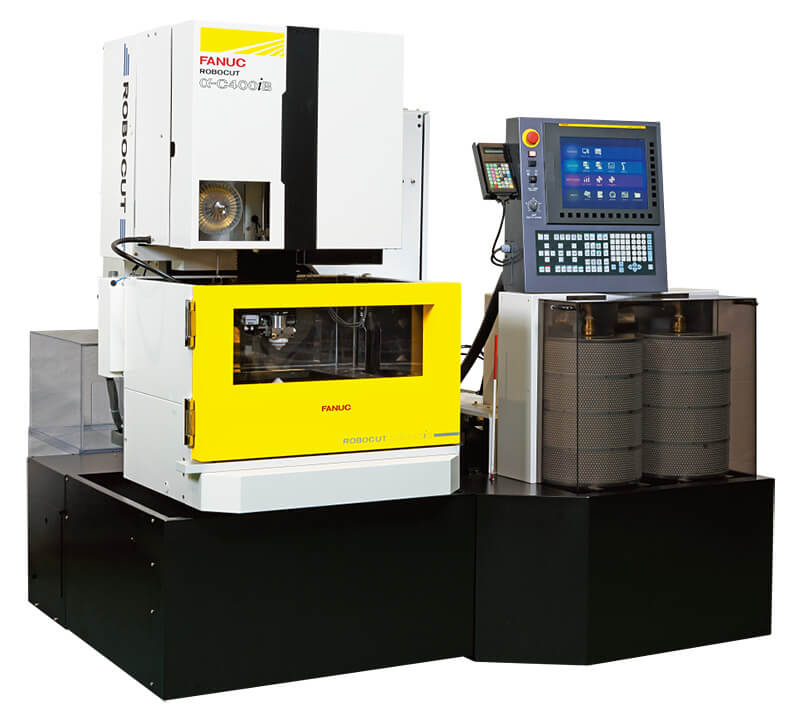

ROBOCUT a-C400iC
ROBOCUT α-C400iC Wire EDM
Compact and ultra‑precise, the ROBOCUT 𝛼‑C400𝑖C delivers high‑accuracy micro‑machining for aerospace, automotive, and advanced manufacturing.

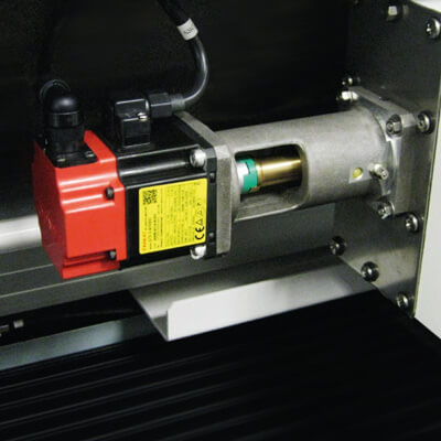

  • Accurate twin servo wire tension control

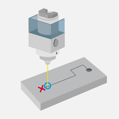

Faster Positioning
ROBOCUT’s Smart Positioning function gets you started faster by cutting the time it takes the wire EDM machine to measure geometrical references on the workpiece.

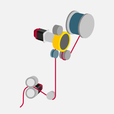

Fea pr rc consistent wire tension
Consistent Wire Tension
FANUC’s unique twin servo wire tension control maintains wire tension to +/- 15 g of accuracy for consistent machining, fewer wire breaks and reduced parts wear.

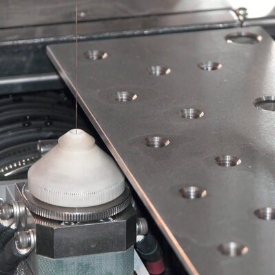

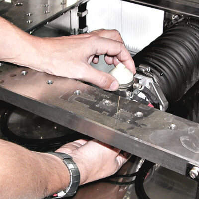

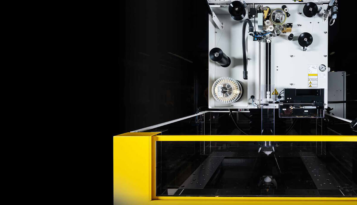

Automatic wire threading in just 10 seconds.
FANUC’s unique AWF3 Automatic Wire Feed threading technology provides fast, reliable automatic threading in just 10 seconds. To ensure reliable threading and re-threading, wires are cut electrically leaving a pointed end that is absolutely straight and burr-free, even on soft wire. Aided by a jet of water, threading the wire is both simple and very fast.

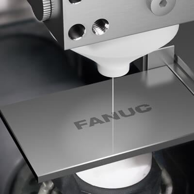

Wire EDM Micromachining
Our thin-wire technology option enables you to reliably thread wire down to a diameter of 0.05 mm.

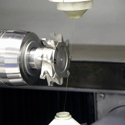

Fea rc ia pcdmachining 2
Easy PCD Tool Programming
A PCD allrounder, ROBOCUT ensures the crystals are not damaged during cutting and provides high-speed precision machining for PCD tool sharpening. Capable of cutting at a variety of different angles, it is ideal for sharpening bonded PCD blanks.

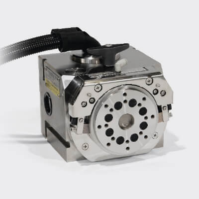

Fea rc pr ccr table
FANUC CCR Table
ROBOCUT is available with a CCR rotary table. This lightweight universal rotary table comes with high-resolution glass scales and, for maximum concentricity, provides optimum travel between the U and V axes.
