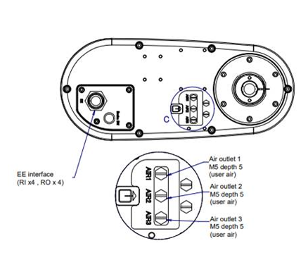

Sr 3iau integratedservices diagram better
Integrated Services
The FANUC SR-3iA/U is a ceiling mounted SCARA robot with built-in integrated services such as I/O and 24VDC, solenoid valves, and air lines in the arm that simplify integration and reduce costs.
