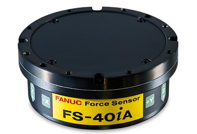

Fanuc force sensor fs 40ia
FS-40iA
6 Axis
Dim Ø 105x47
392N/40kgf related load

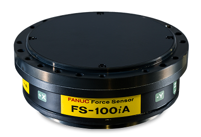

Fanuc force sensor fs 100ia
FS-100iA
6 Axis
Dim Ø 155x59
980N/100kgf related load
