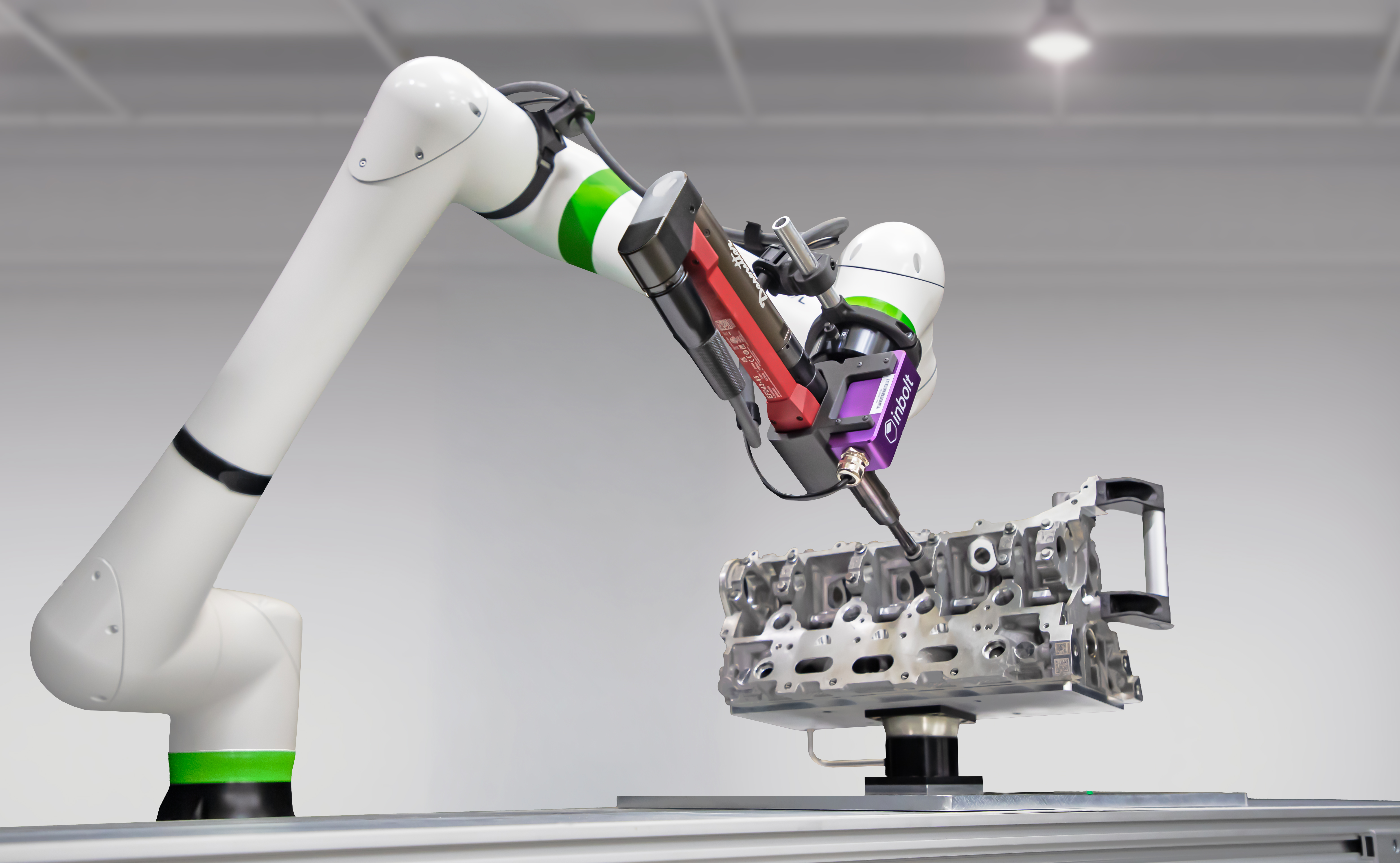

CRX 20i A L Dynamic Line Tracking Inbolt
AI Robot Tracks Moving Parts and Tightens Screws
FANUC robots can identify and track workpieces moving in three dimensions, following them precisely in real time. This enables operations such as tightening screws on moving parts, a task that traditionally required precise fixturing or part stabilization. With 1 millisecond high-speed tracking performance, high-speed 3D tracking ensures consistent accuracy even in dynamic environments.

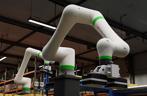

AI Agent Kitting
AI Agent-Driven Kitting Operations
By issuing instructions in natural language to the AI agent for tasks like photographing order forms, recognizing text, and transporting trays and parts, a robot can execute the kitting of workpieces. By combining an AI agent—which understands natural language to control the robot and autonomously execute tasks—with a masterless AI recognition function that identifies objects based on natural language inputs, it becomes possible to modify operation logic, just as if instructing a human.

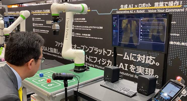

Generative ai with robot provide instructions by voice
Robot Programming by Voice with Generative AI
FANUC robots can recognize voice commands in multiple languages, automatically generate Python programs using generative AI, and execute the resulting tasks while perceiving their surroundings. Users provide instructions verbally, and the robot interprets the language, generates the appropriate program and carries out the requested action.
These capabilities also support complex tasks such as:
  • Rolling a die and placing it in the correct location based on the number shown
  • Stacking a die of a specific color on top of another
These tasks previously required specialized programming but can now be executed through intuitive voice commands.
