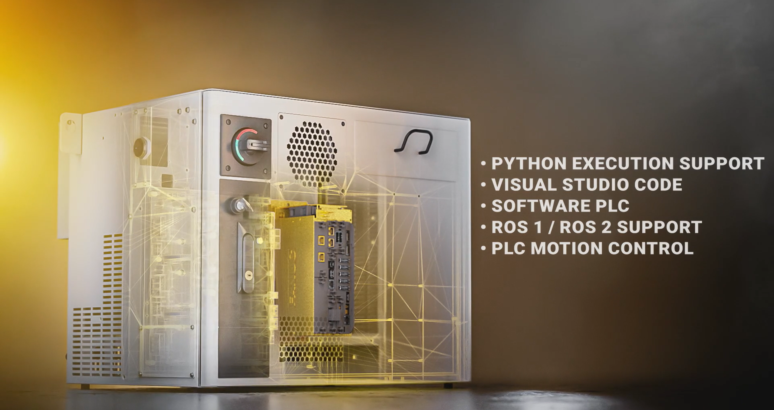

Python on the Robot Controller
Run Python on the R-50iA Controller

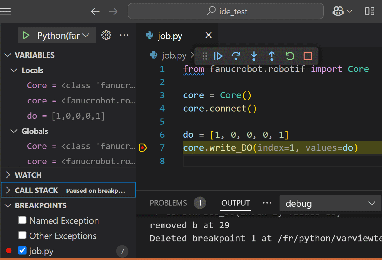

The globally popular programming language Python can now be executed directly on the R-50iA controller. This robot control enables seamless integration of rich open-source libraries—such as those for statistical processing, data analysis, and image processing—into robot control. The development environment supports VS Code (Visual Studio Code), allowing efficient program development with advanced remote debugging features such as step execution, breakpoints, and variable views.

FANUC provides dedicated Python libraries to simplify robot control. Using these libraries, developers can intuitively access various robot data from Python, such as I/O (signal input/output) and register values (variable settings). Furthermore, by combining the optional Remote Motion Interface, robots can be commanded to move directly from Python. Python programs created in this way can also be called from conventional TP programs, enabling seamless integration of FANUC robots with the latest technologies.
