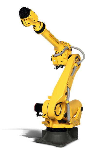

R-2000 Series
R-2000iC/210F
210 kg
2655 mm
1090 kg
Featuring a huge 210 kg payload, this model is ideally suited to any number of heavy handling jobs on almost any application. With numerous mounting options available to make best use of space and create an optimal work envelope, it makes an excellent spot welding robot. Additional options make it suitable for food processing applications or wet environments.

Compatible Controllers
210 kg
Floor
±0.05 mm
2655 mm
1090 kg
3 kW
370°
136°
312°
120°/s
105°/s
110°/s
140°/s
140°/s
220°/s
1360/225.4
1360/225.4
735/196
IP54 / IP56
R-30iB Plus A-Cabinet
