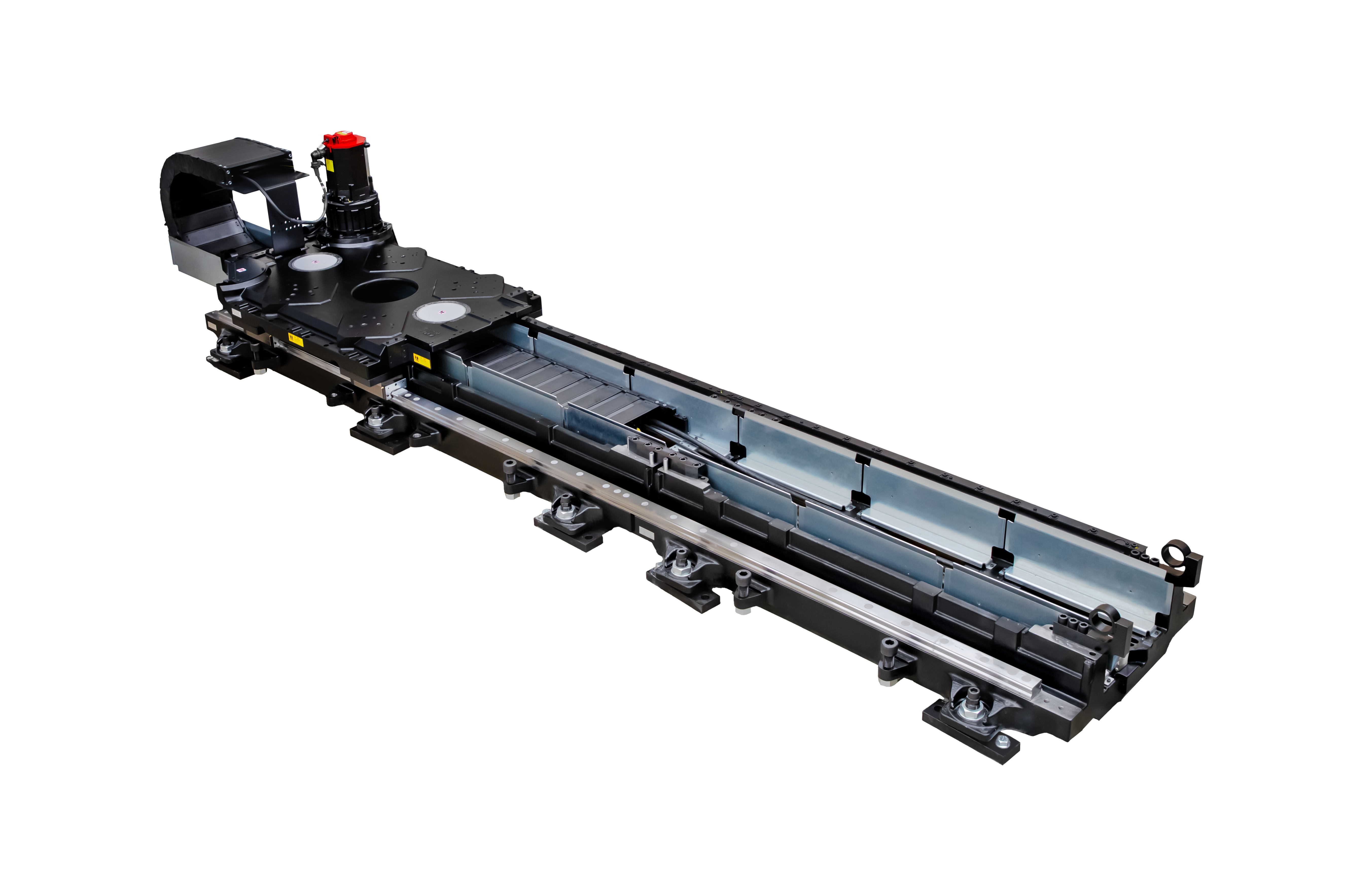

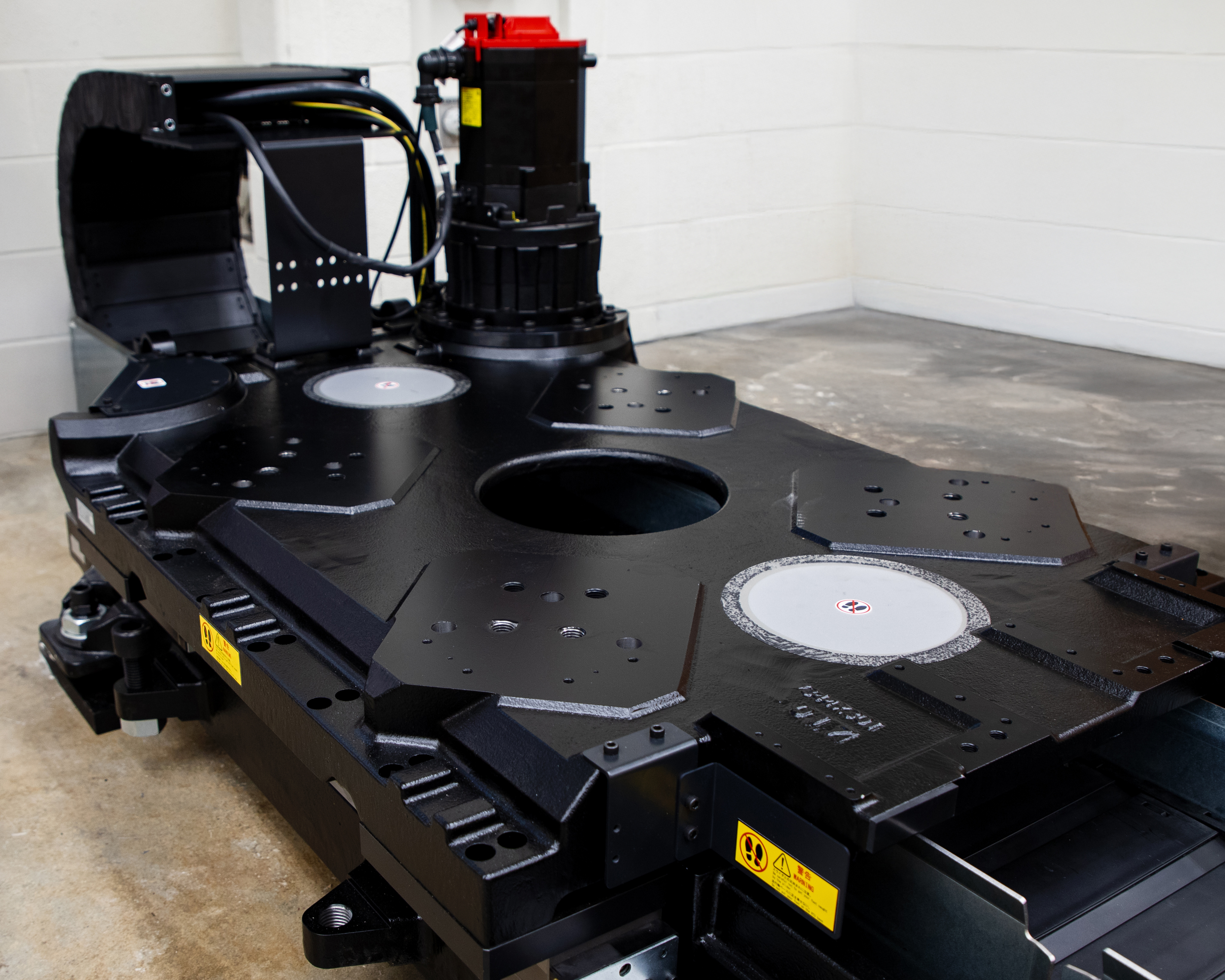

The Modular RTU expands the capabilities of FANUC M-710, R-1000, R-2000, and M-800 robots with a servo-driven rail system supporting up to 2000 kg payloads. Featuring an adjustable stroke length up to 20 meters and a compact, modular design, it maximizes flexibility and floor space efficiency. Fully integrated software enhances robot performance, while factory-assembled quality ensures reliability. Supported by FANUC’s global service network, the Modular RTU delivers consistent, scalable automation for demanding applications.
Key Features of the Modular RTU
Supported robots
M-710s, R-1000 series, R-2000 series, and M-800
2000kg payload capacity on carriage
Adjustable stroke length up to 20m and modular design
Modules and extensions are combined to form 1m to 20m rails at 0.5m increments
Compact footprint and silhouette
Enhanced software functions integrated into the robot software
Modular RTUs 2000kg software option (S630).
Reliable factory-assembled quality
Global supply and maintenance through FANUC’s sales and service network
