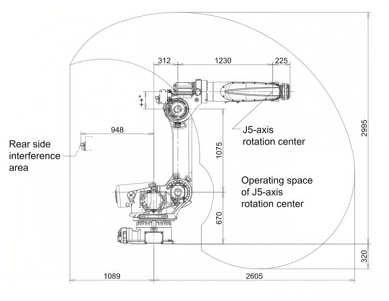

165 kg
Floor
±0.05 mm
2605 mm
1150 kg
3 kW
370°
140°
236°
420°
420°
130°/s
110°/s
115°/s
175°/s
170°/s
280°/s
1000/122
1000/122
620/100
