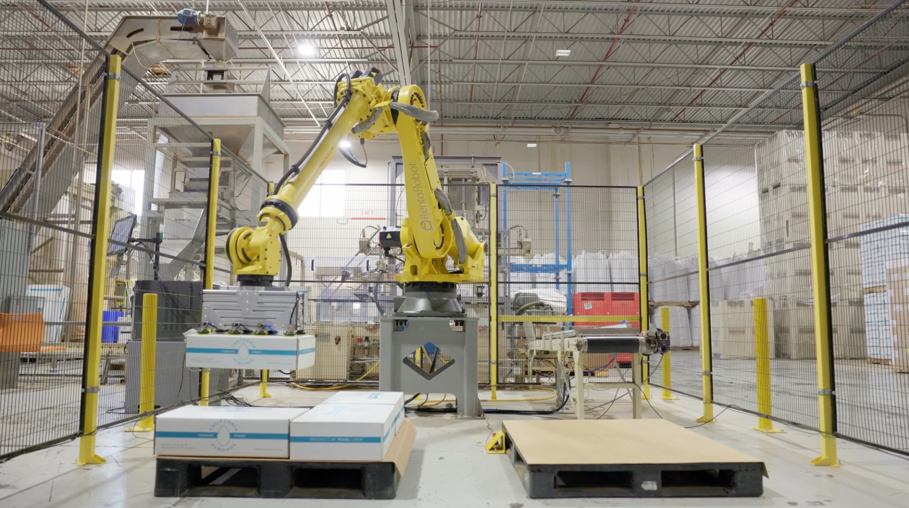

Working closely with Pearl Crop, RentoRobot deployed FANUC robotic systems tailored to the company's different production environments. For applications where floor space was limited and production speeds were moderate, the FANUC CRX collaborative robot proved to be an ideal solution.
Its compact footprint and ease of deployment allowed the system to be moved between production lines while providing automated pick-and-place and palletizing capabilities. The collaborative design also provided flexibility for operations where employees and automation needed to work in close proximity.
For higher-volume applications requiring faster cycle times and heavier lifting, RentoRobot implemented a FANUC R-2000 industrial robot. Designed to handle demanding palletizing operations, the robot enabled Pearl Crop to automate the movement of 50-pound boxes at production speeds that would be difficult to maintain manually.
The impact was immediate. Automated palletizing improved consistency and production flow while eliminating repetitive lifting tasks that previously placed strain on employees. In one operation line, a process that had traditionally required four workers became fully automated. Rather than eliminating jobs, Pearl Crop reassigned those employees to other roles where they could contribute more value and develop new skills.
Employee response to the automation has been overwhelmingly positive. Workers no longer spend entire shifts bending, stretching, lifting and stacking heavy boxes. Instead, they can focus on more skilled operational tasks while the robots handle the repetitive, physically demanding work.
Today, Pearl Crop has deployed more than six robotic systems across its operation, with additional automation projects already planned. The increased throughput and operational efficiency created by automation have enabled the company to focus greater attention on innovation, customer needs and future growth.

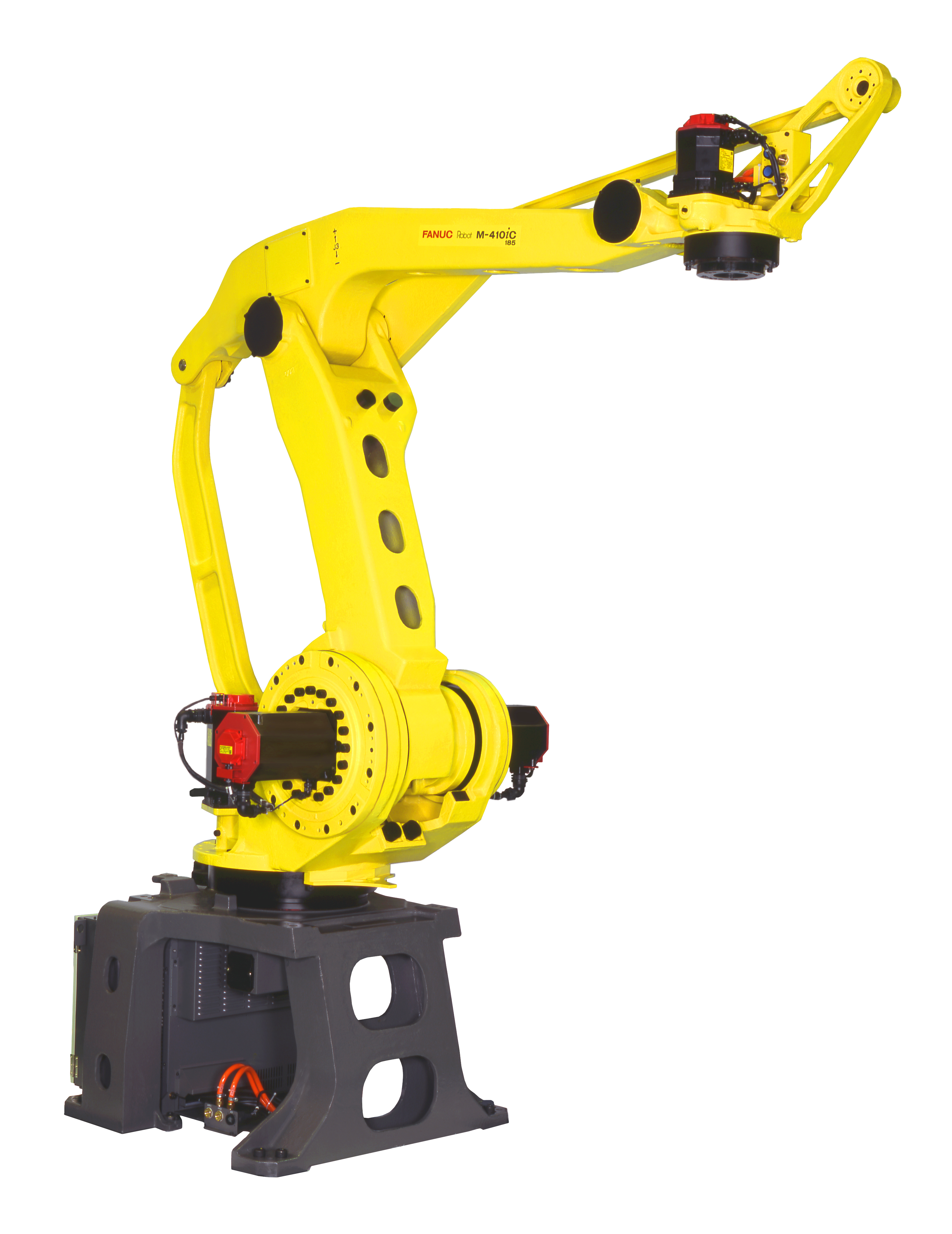

M-410iC/185
Palletizing Robots
M-410iC/185
The FANUC M‑410iC/185 is a compact 4‑axis palletizing robot for high speed palletizing, assembly, machining and parts transfer applications.
185 kg
3143 mm
View M-410iC/185

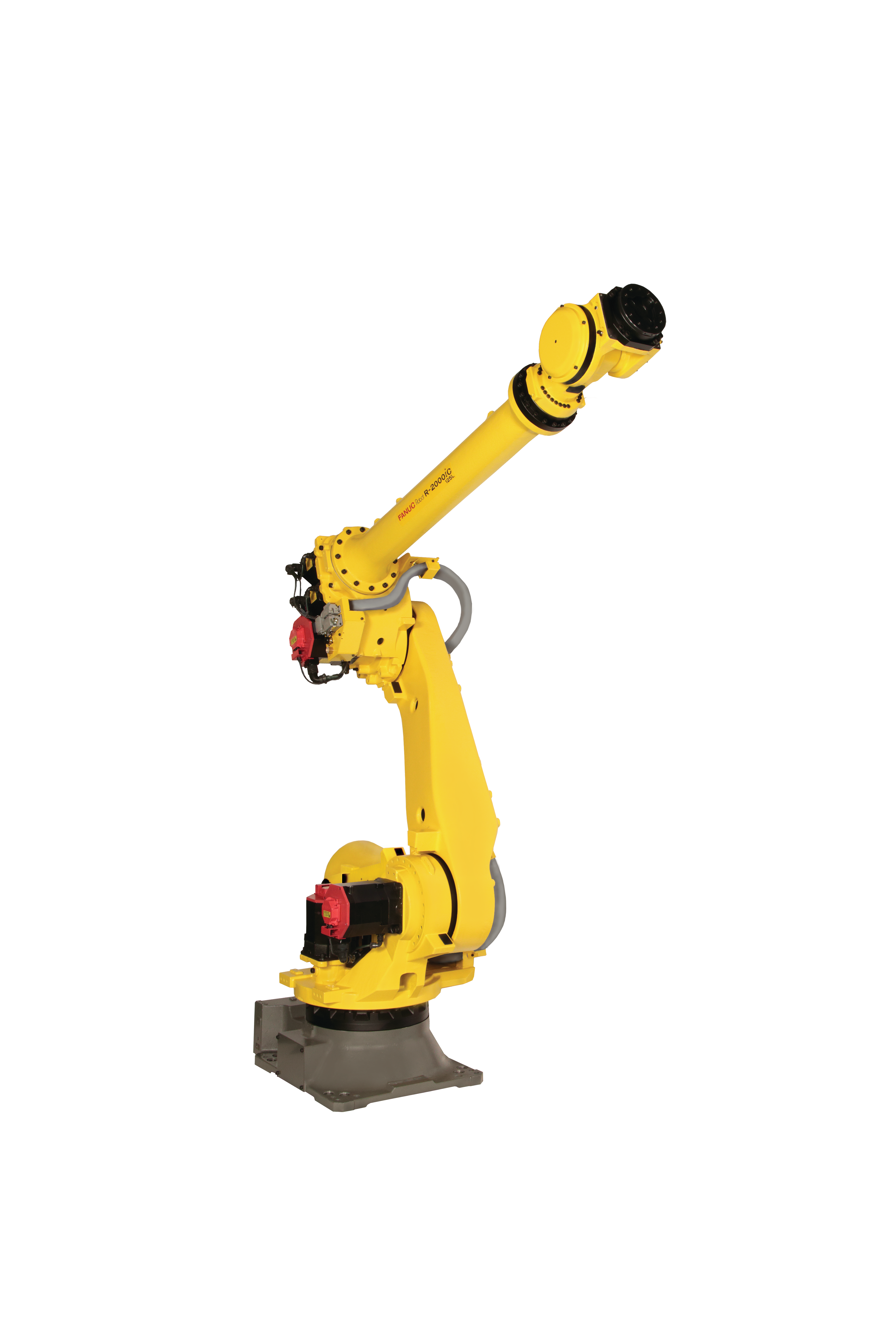

R-2000iC/125L
Equipped with 6 axes for ultimate flexibility, the FANUC R‑2000iC/125L robot is capable of handling heavy loads precisely within a generous work envelope
125 kg
3100 mm
View R-2000iC/125L
