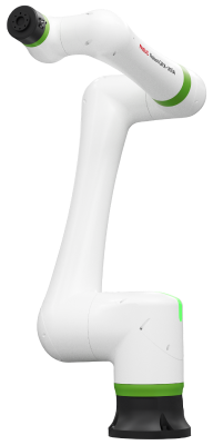

As one of the latest additions to our line of cobots, the CRX-30iA is one of the heavier lifters of the FANUC CRX series. With a payload of 25-30 kg and a reach of 1756 mm, the CRX 30-iA is perfect for tasks that demand extra lifting in a collaborative setting, while preserving the safety and simplicity of programming that the CRX series is known for.
It is the first FANUC cobot to feature standard wrist button functionality, located on the J6 flange. You can now directly teach the robot new movements using the customizable buttons right on its wrist, giving you total control and flexibility.
A great choice for palletizing, material handling, machine tending, welding, and more, the CRX 30-iA is a perfect introduction to automation for manufacturers across various industries.

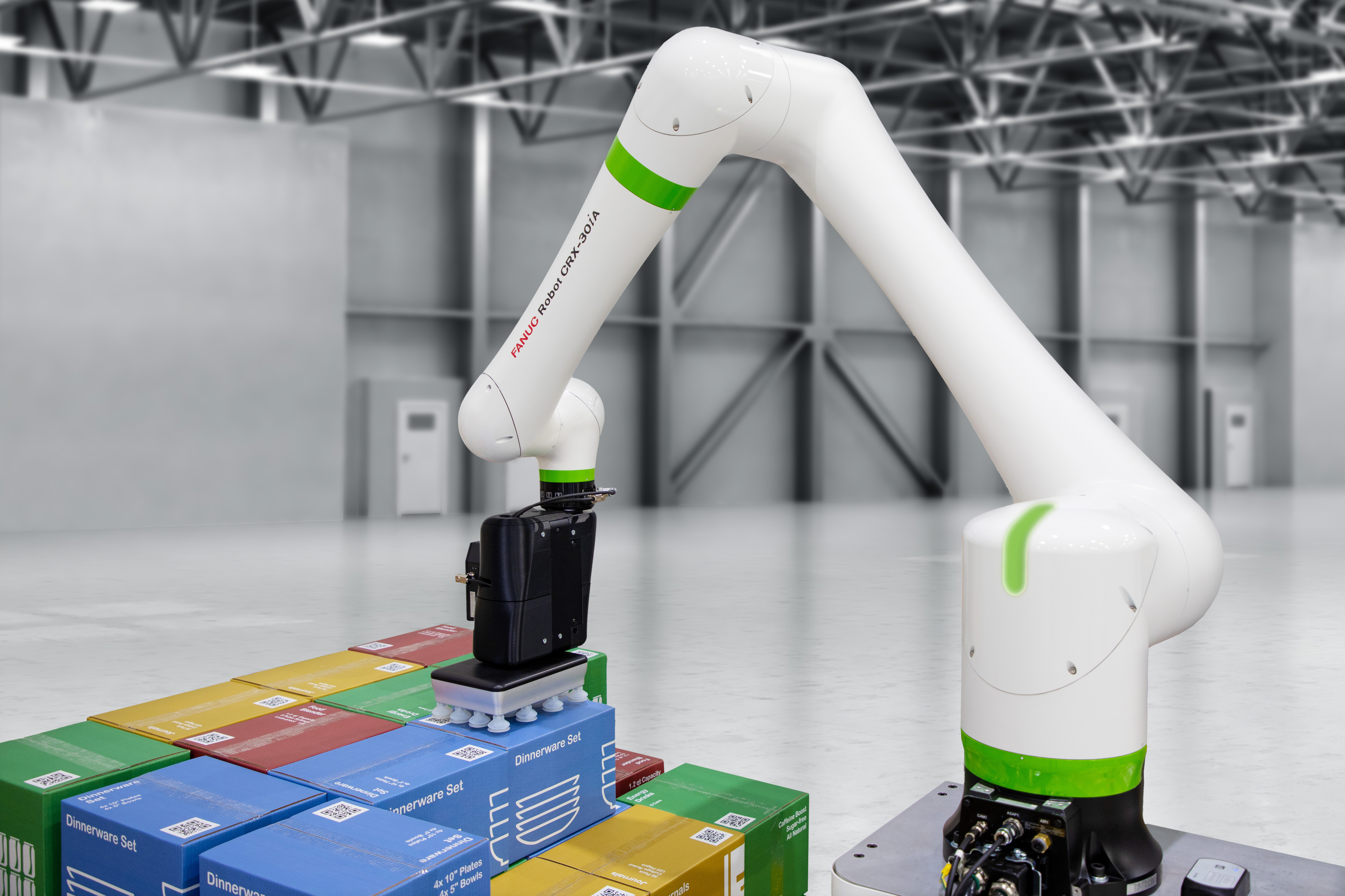

Boost Your Palletizing Performance

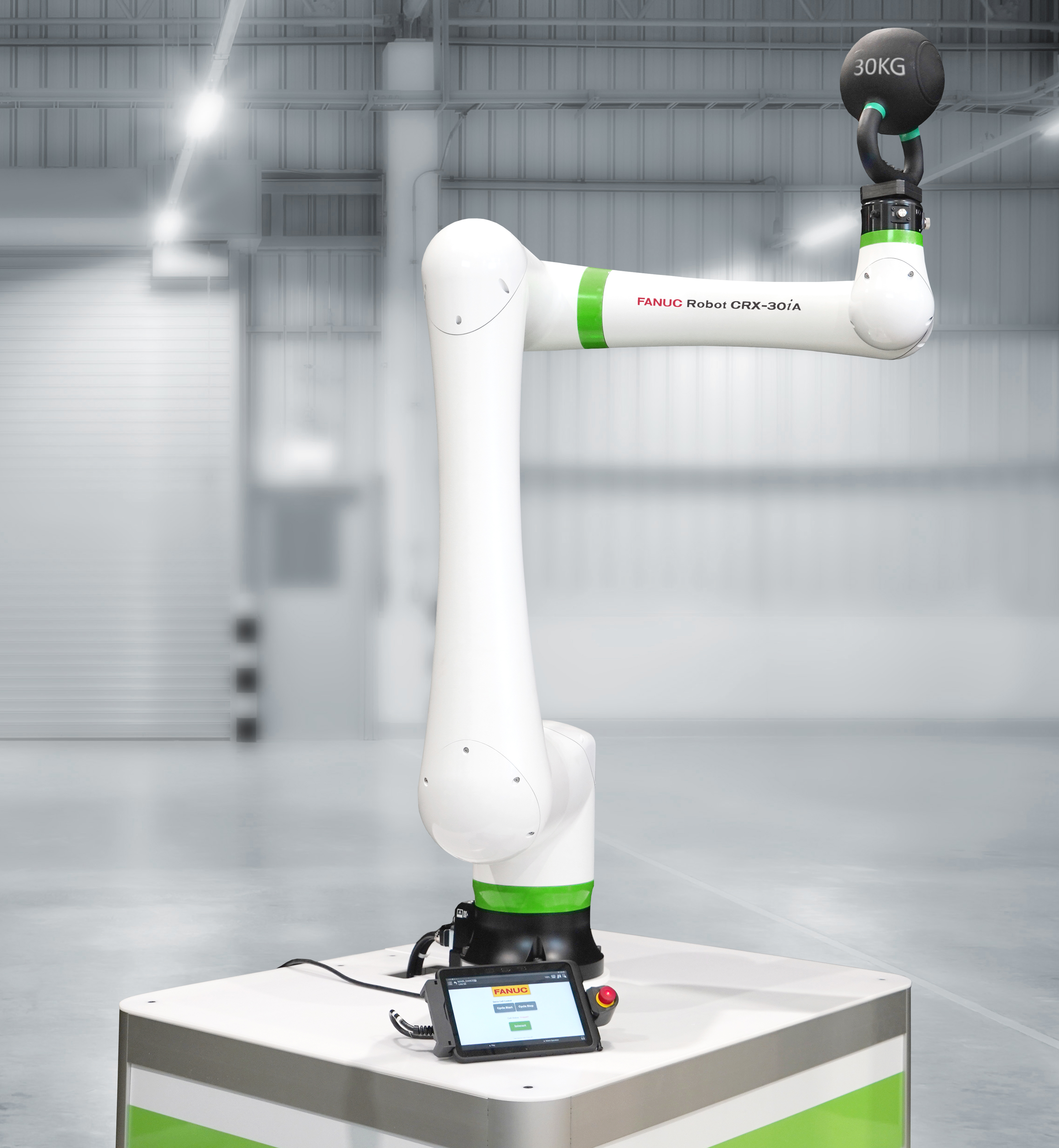

CRX-30iA – 40 kg Payload Option
The CRX-30iA now offers an enhanced 40 kg wrist-down payload option, delivering greater capability for demanding palletizing applications while maintaining the CRX series’ industry-leading ease of use.
Robot payload
40 kg Wrist‑Down Payload Capacity
Designed specifically for high‑demand palletizing, this option enables handling of heavier cases, totes, and materials with confidence and stability.

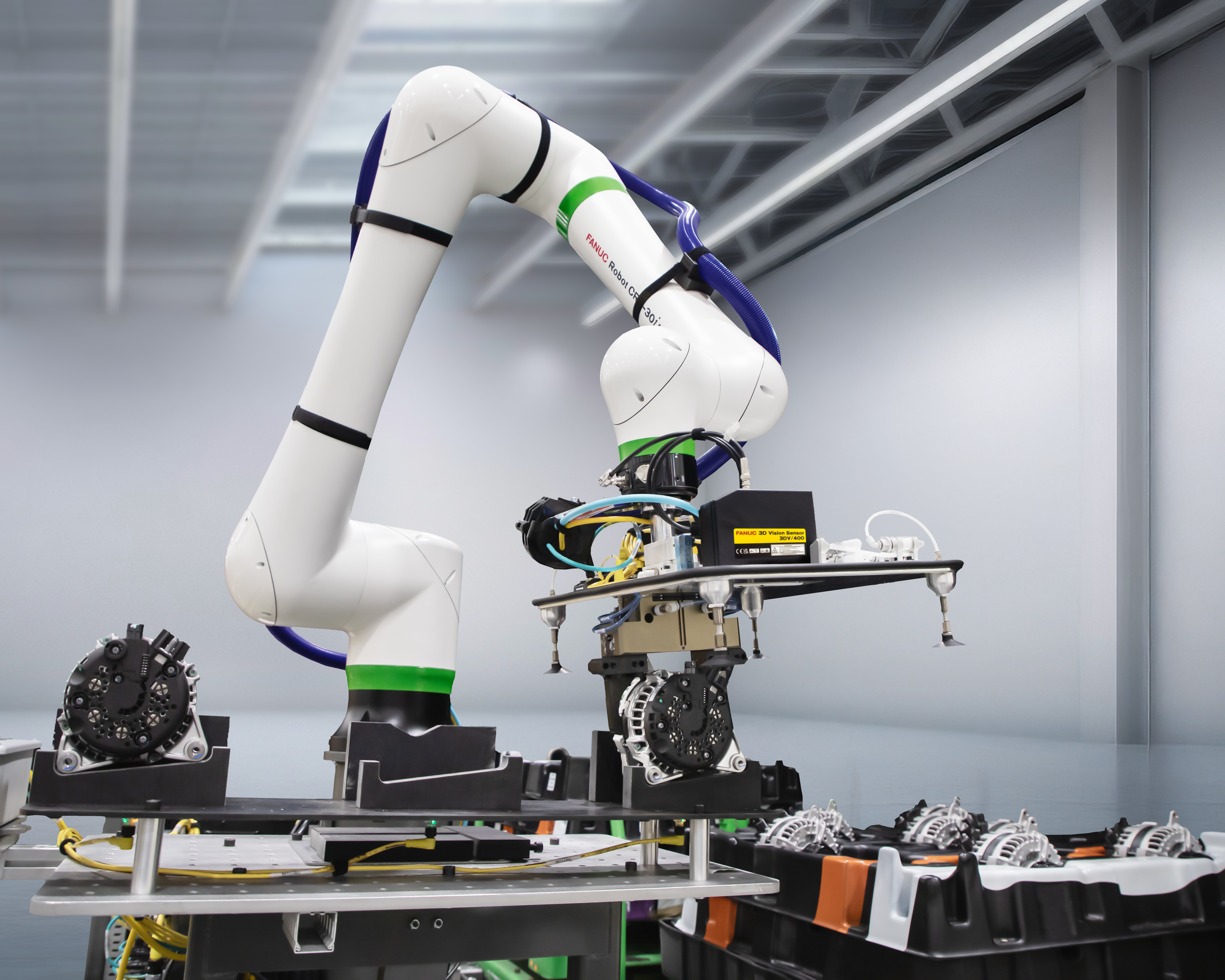

CRX 30i A Material Handling Alternators

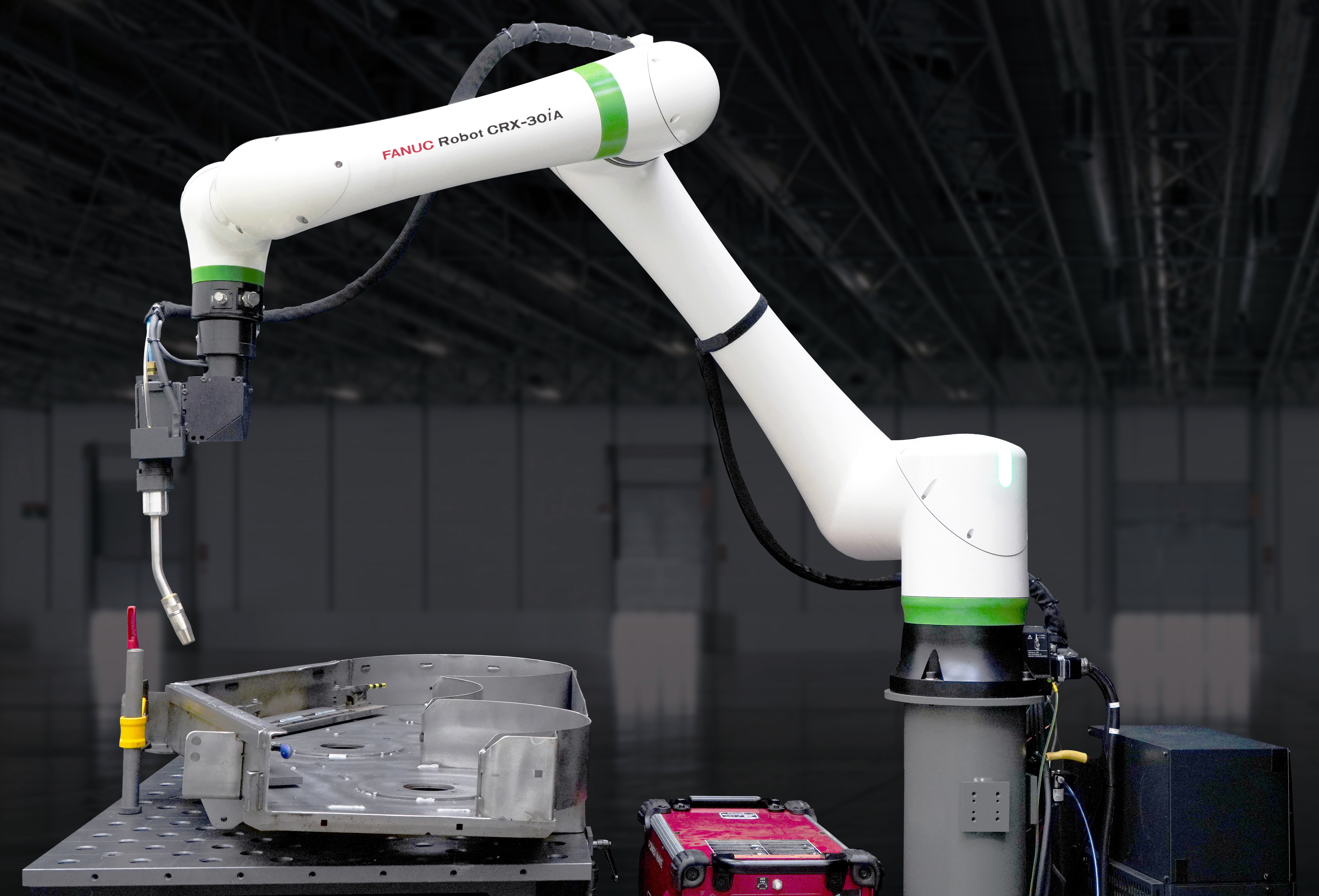

Cobot Welding with a Drop Center Positioner
A high-payload cobot and drop-center positioner coordinate part movement for improved weld access, consistency, and production flexibility.

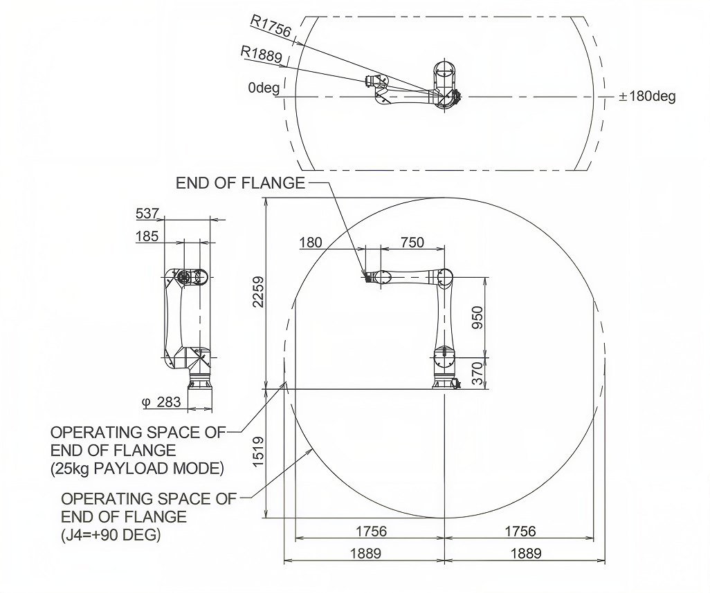

30 kg
±0.05 mm
1889 mm
135 kg
360°
360°
540°
380°
360°
450°
