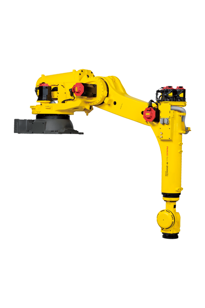

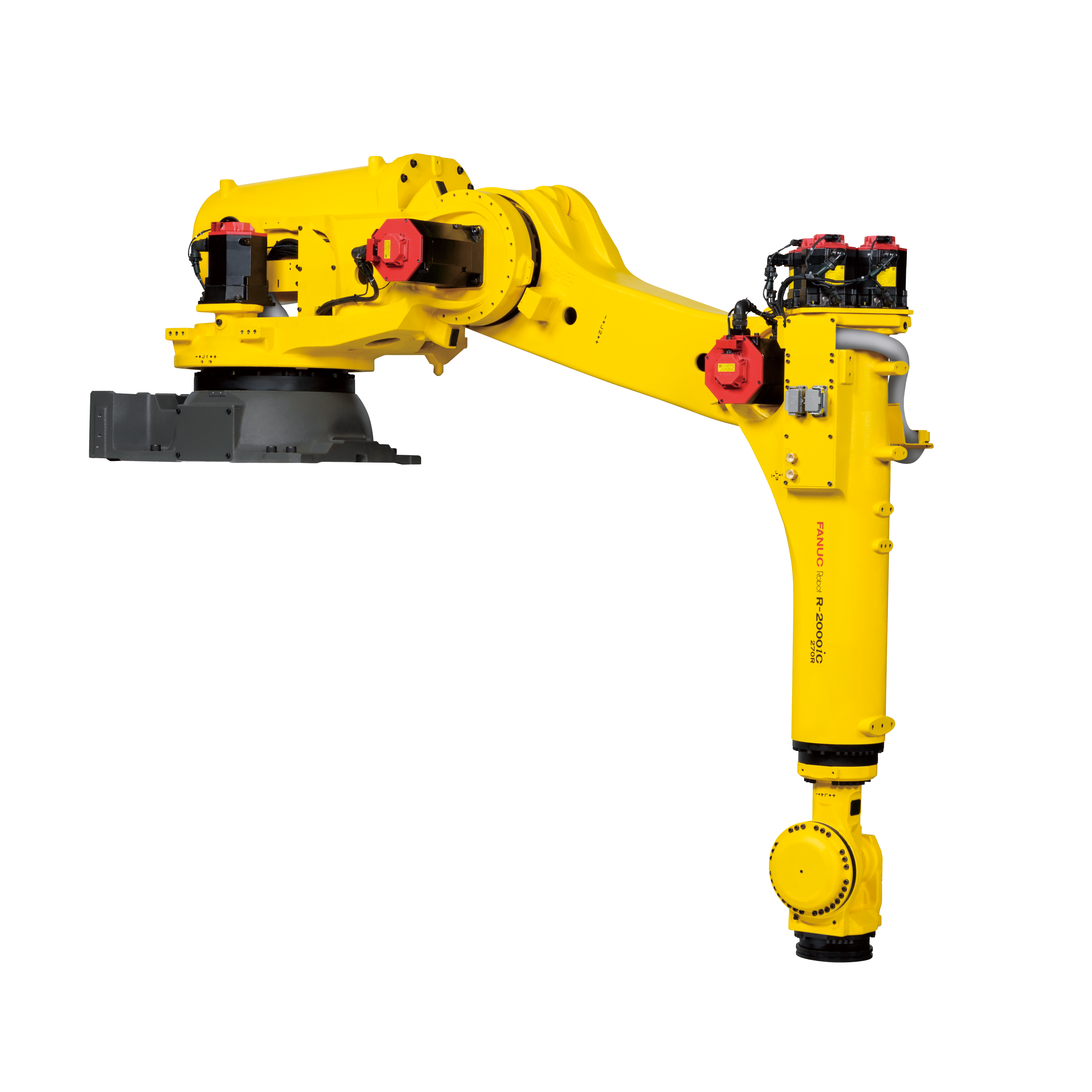

The latest edition to the R-2000iC series, completes the portfolio of rack-mounted robots up to high payload classes. With an enforced J3 arm, this model is able to carry payloads up to 270 kg. It provides enormous flexibility thanks to its huge 3095 mm work envelope and the rack mounting also saves you valuable floor space. Offering high performance and excellent payload capacities, it is the perfect solution for a multitude of high-payload applications.
R 2000ic270r
Rack-mounted robot with highest payload
With an enforced J3 Arm, this R-2000iC/270R rack-mounted robot is able to carry payloads up to 270 kg. Rack mounting combined with this model's huge reach, makes getting the tool right to the spot easy, regardless of your workspace.
R 2000ic270r
Big 3095 mm reach
Rack mounting combined with this model's huge reach, makes getting the tool right to the spot easy, regardless of your workspace. Saving precious floor space, this rack mount R-2000 adds versatility to your installation.
