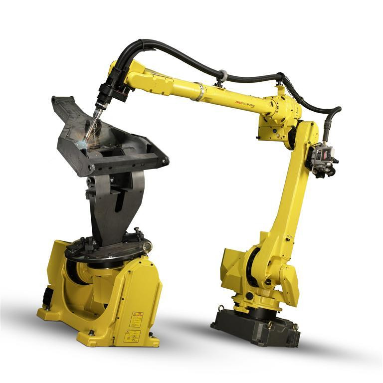

This new small to medium payload 6-axis model is ideal for all applications to handle medium payloads for up to 12 kg. With the smallest payload capacity in the M-710 series, it has extended, long arm reach (3.1 m), making it the perfect choice for robotic sealing applications when working on car body interiors or other hard to reach areas.
M710ic 20l robot welding metal banner
Compact cell design
High workspace flexibility on a small foot print for easy access even in narrow spaces.
M710ic 20l tool attached banner
IP67 wrist protection as standard
Thanks to its dust and waterproof wrist, this model is ideal for entering harsh environments.
M710ic 20l left view robot banner
Very long J3 arm
With its extended 3110 mm reach and very accurate repatability of ± 0.06mm, this model is ideal for sealing applications inside car bodies.
M710ic 20l top mounted banner
Flexible installation options
Full working envelope when robot is mounted upside down. Flexible cell design with no interference, allowing several robots to work together in close proximity.

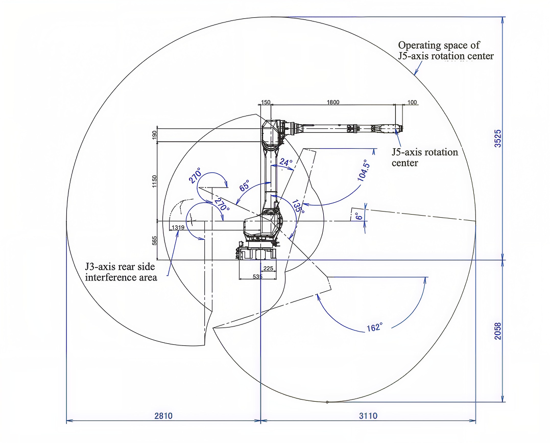

20 kg
±0.06 mm
3110 mm
540 kg
3 kW
360°
225°
432°
400°
280°
900°
175°/s
175°/s
180°/s
350°/s
360°/s
600°/s
39.2/.88
39.2/.88
19.6/.25
IP54 / IP67
