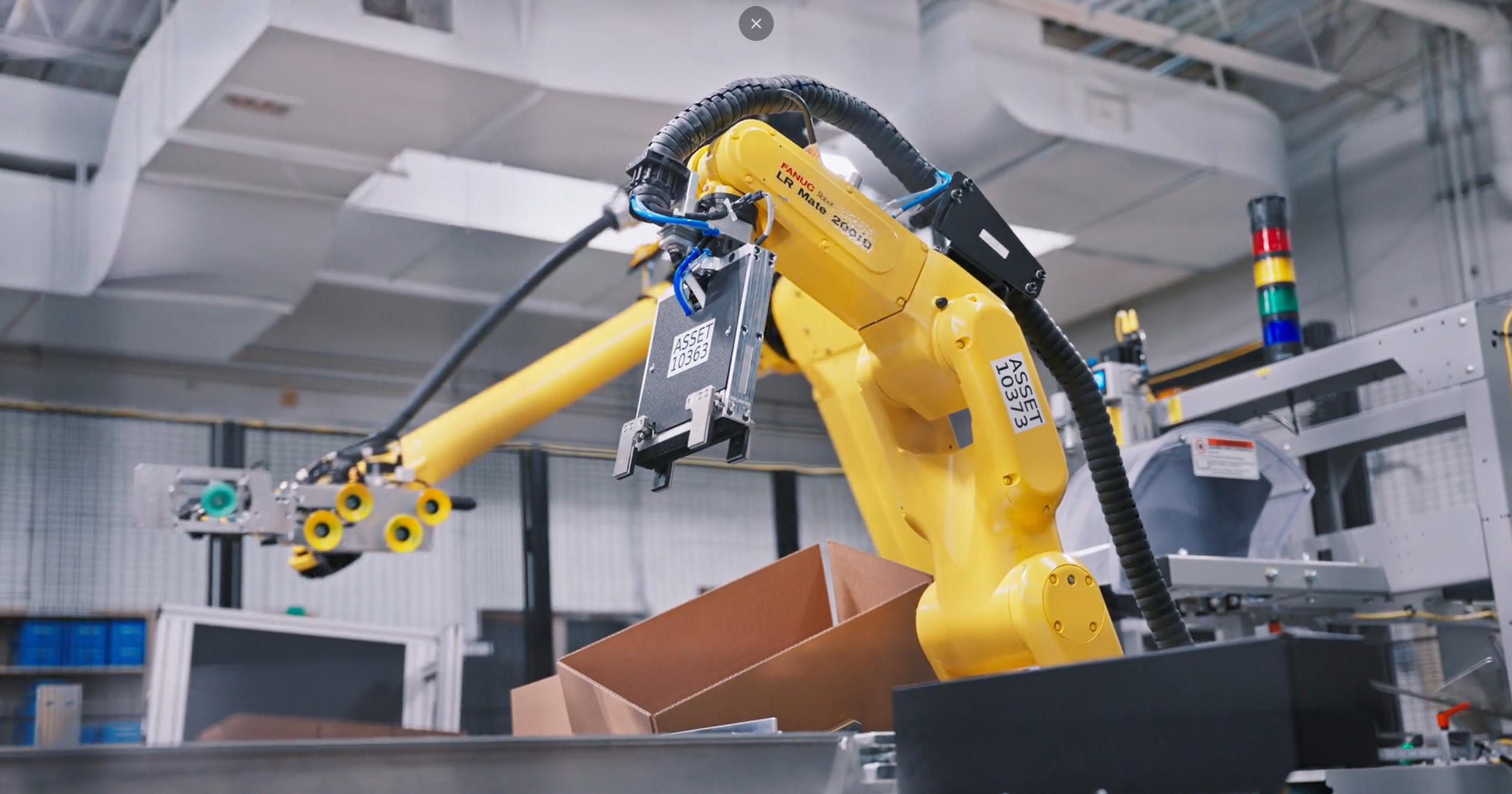

To address these challenges, Inland partnered with DEVELOP, a Wisconsin-based automation company and FANUC Authorized System Integrator. Working together, DEVELOP engineered and built a fully custom robotic end-of-line packaging and palletizing cell designed specifically for Inland's production environment.

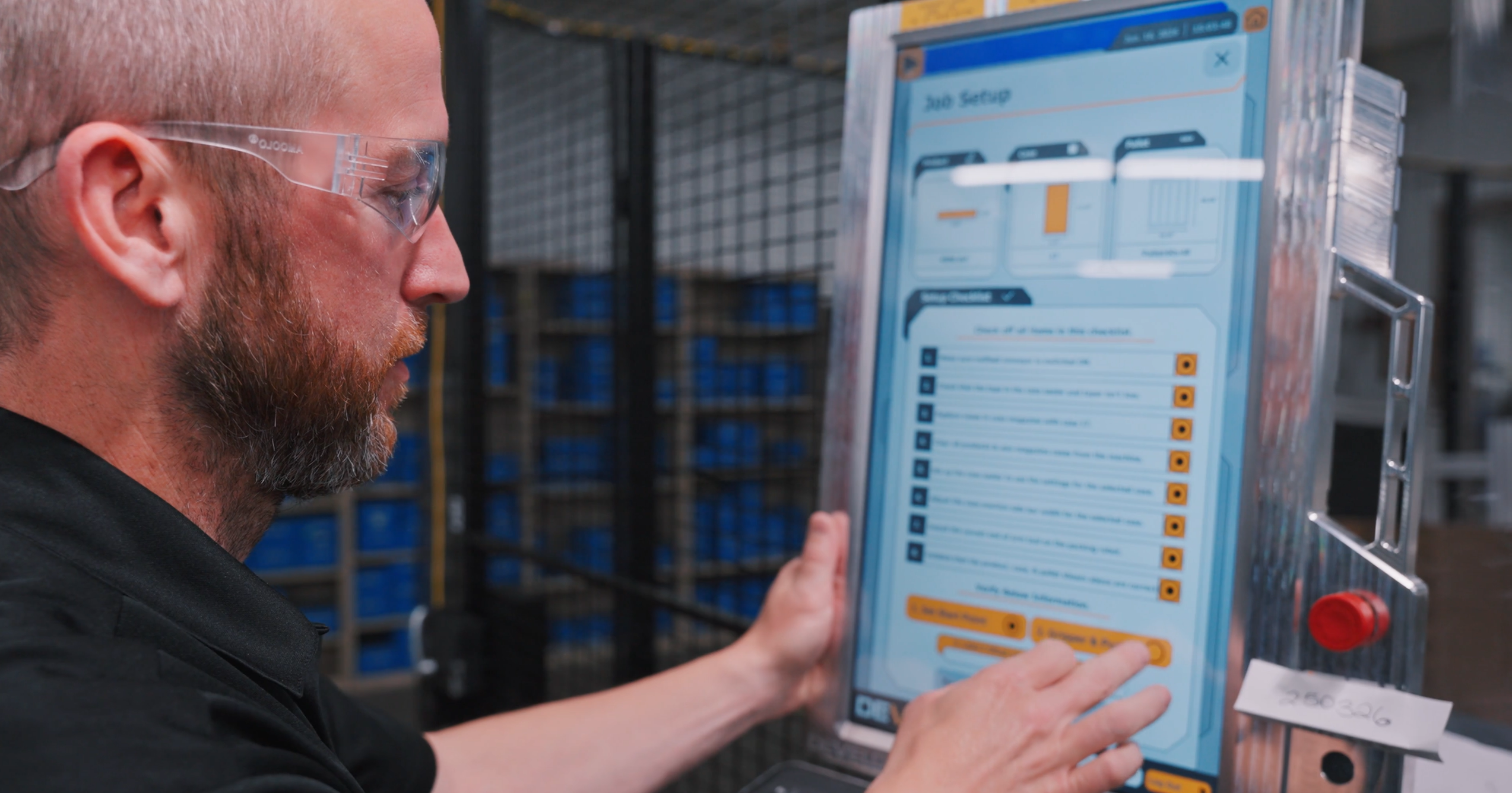

The resulting solution—which was designed to fit precisely within the available space—combines packaging and palletizing functions into a compact automation cell while maintaining a simple operator experience. The entire system operates through a single HMI screen with intuitive visual instructions built directly into the interface.
The simplicity of the system dramatically reduced training requirements. Operators were able to gain confidence running the equipment within hours, and some employees successfully operated the system independently after just a few hours of instruction on their first shift.

Unlike many automation projects that reach peak performance immediately after startup, this one continued to improve after installation. DEVELOP engineers remained engaged with Inland's team, analyzing performance and making ongoing optimizations. The original cycle time target of 4.5 seconds was reduced to 4.2 seconds within six months, with additional improvements expected.
The labor benefits were equally significant. The automated cell enabled Inland to reduce staffing requirements from two employees per line to one while maintaining and increasing output. Rather than eliminating jobs, the change allowed Inland to redeploy employees to other areas of the business where additional support was needed, helping the company grow without adding headcount for repetitive palletizing tasks.
