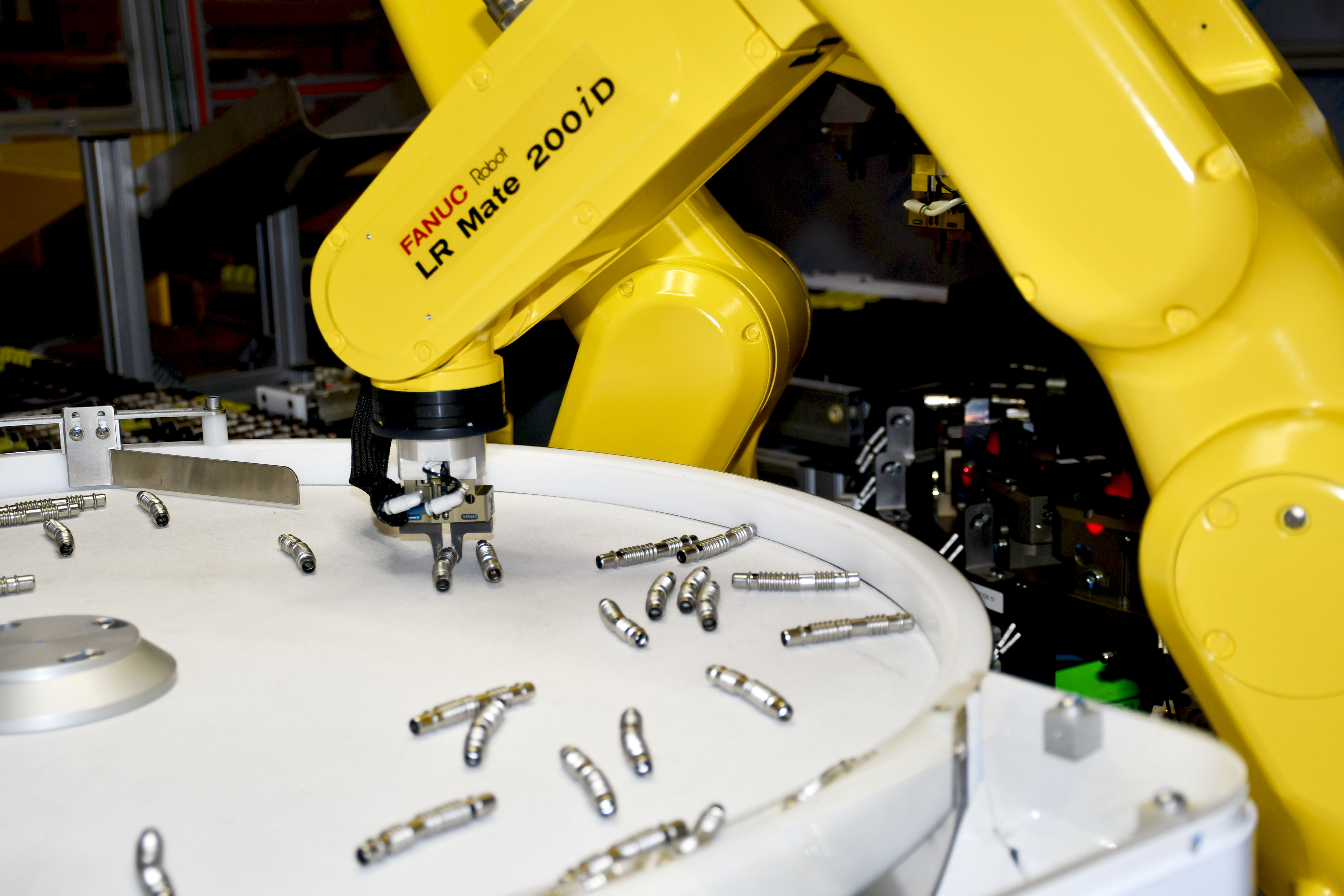

LR Mate 200iD

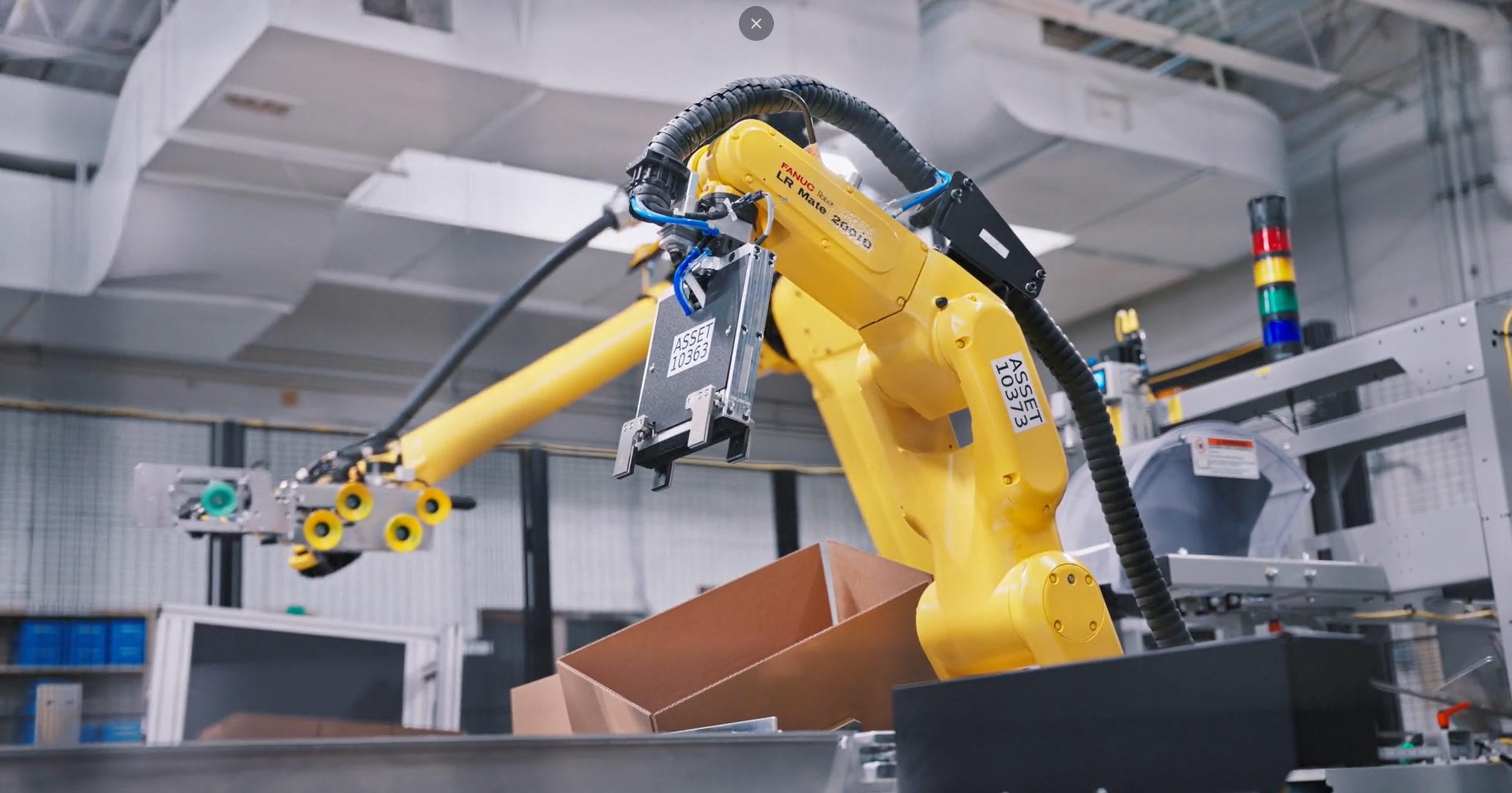

Stainless Tube Assembly All view
Stainless Tube Assembly initial part pickup

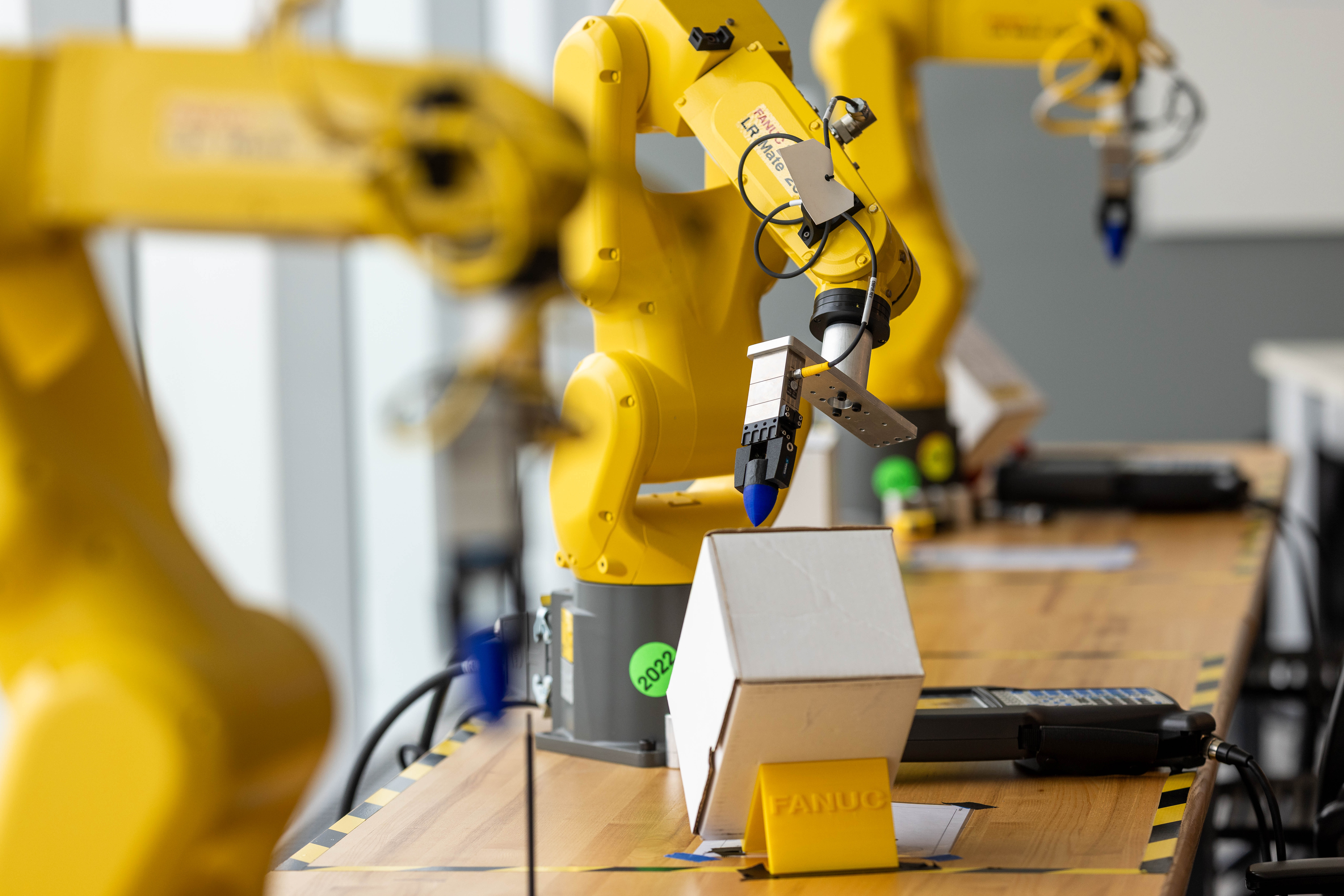

LR Mate 200i D With Teach Pendant
Stainless Tube Assembly Tube pickup 3
Stainless Tube Assembly tube pickup

LR Mate 200i D Machine Loading ROBODRILL
LR mate 200i D Servo Door Machine Tending

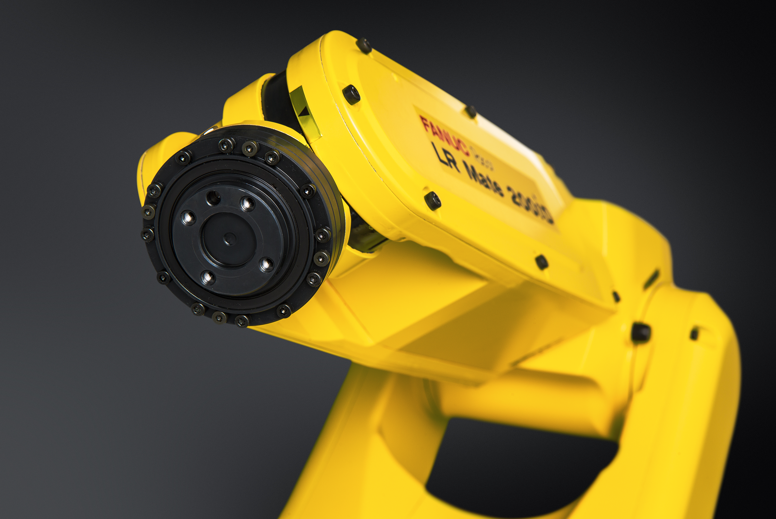

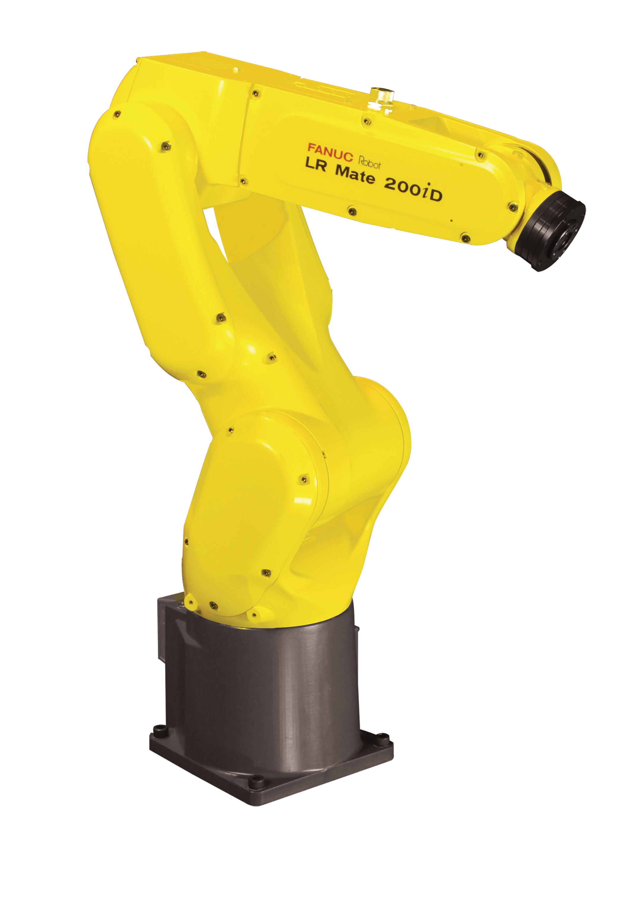

The FANUC LR Mate 200iD is a compact 6 axis robot with the approximate size and reach of a human arm. It combines best-in-class robot weight-load capacity with standard IP67 protection and outstanding FANUC quality. This makes the LR Mate 200iD the best and most reliable mini robot for process automation in many industries.

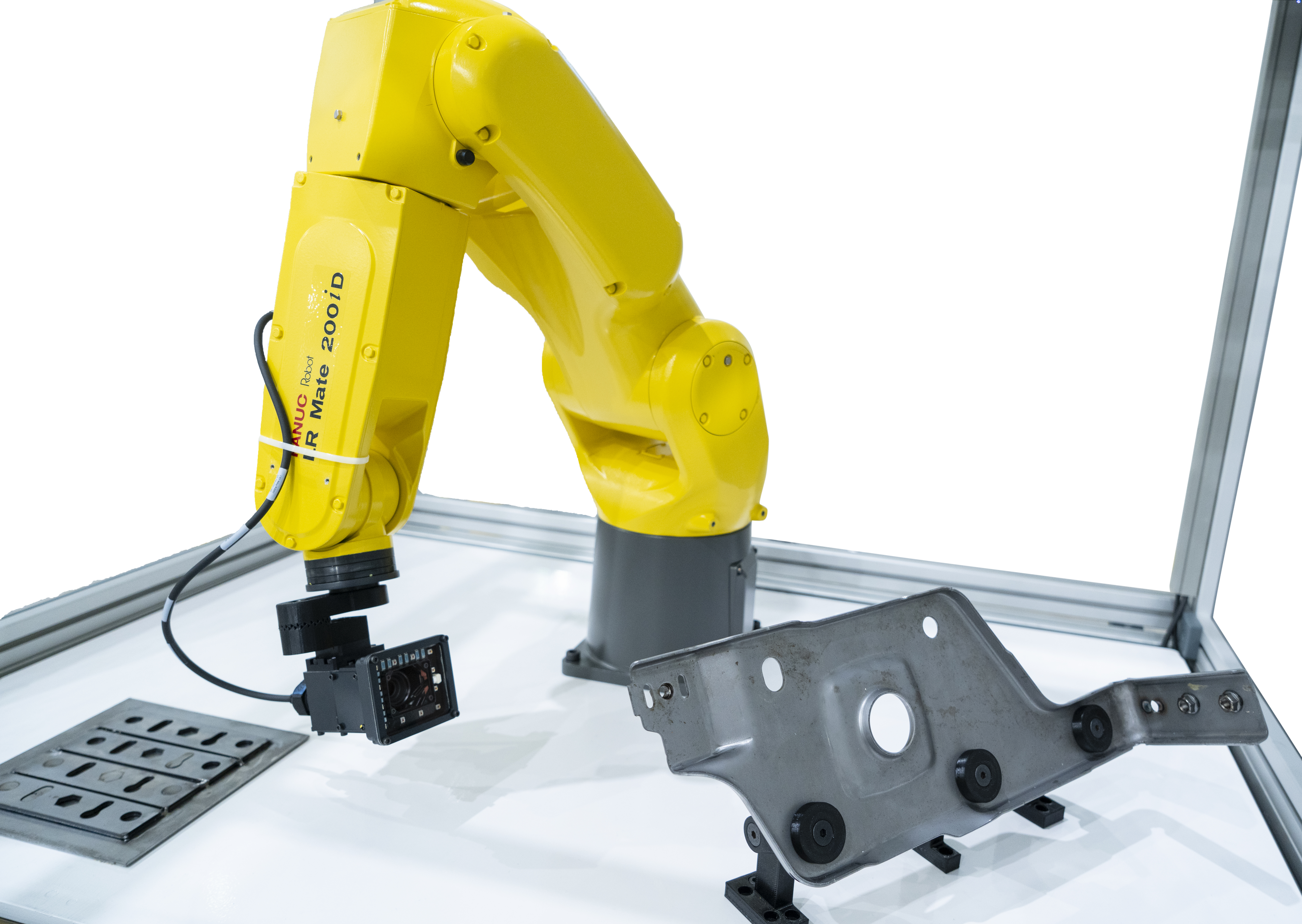

Adapts flexibly to every situation

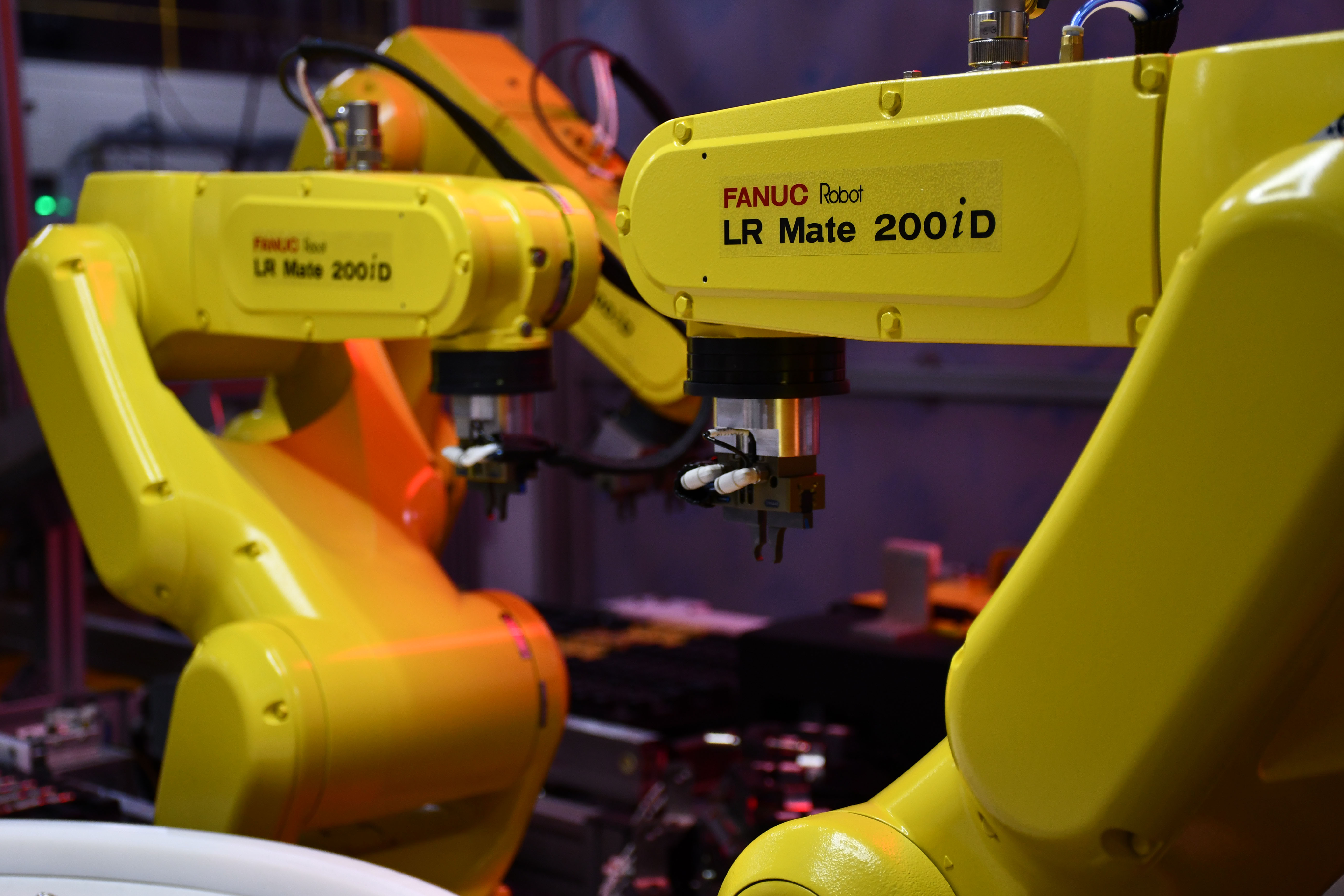

This compact multi-function robot offers you full flexibility thanks to floor, ceiling, wall and angle mounting. With its compact design and sealed mechanical units (IP67) you can even integrate it directly into your machine tool - The possibilities are endless, as FANUC LR Mate mounting options allow for more flexible cell designs, a more robust work envelope, and the ability to run several robots close together.

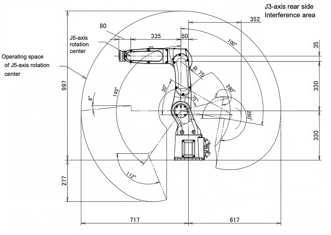

7 kg
±0.01 mm
717 mm
25 kg
1 kW
340°
245°
420°
380°
450°/s
380°/s
520°/s
550°/s
545°/s
1000°/s
16.6/.47
16.6/.47
9.4/.15
IP67 / IP69K
IP67 / IP69K

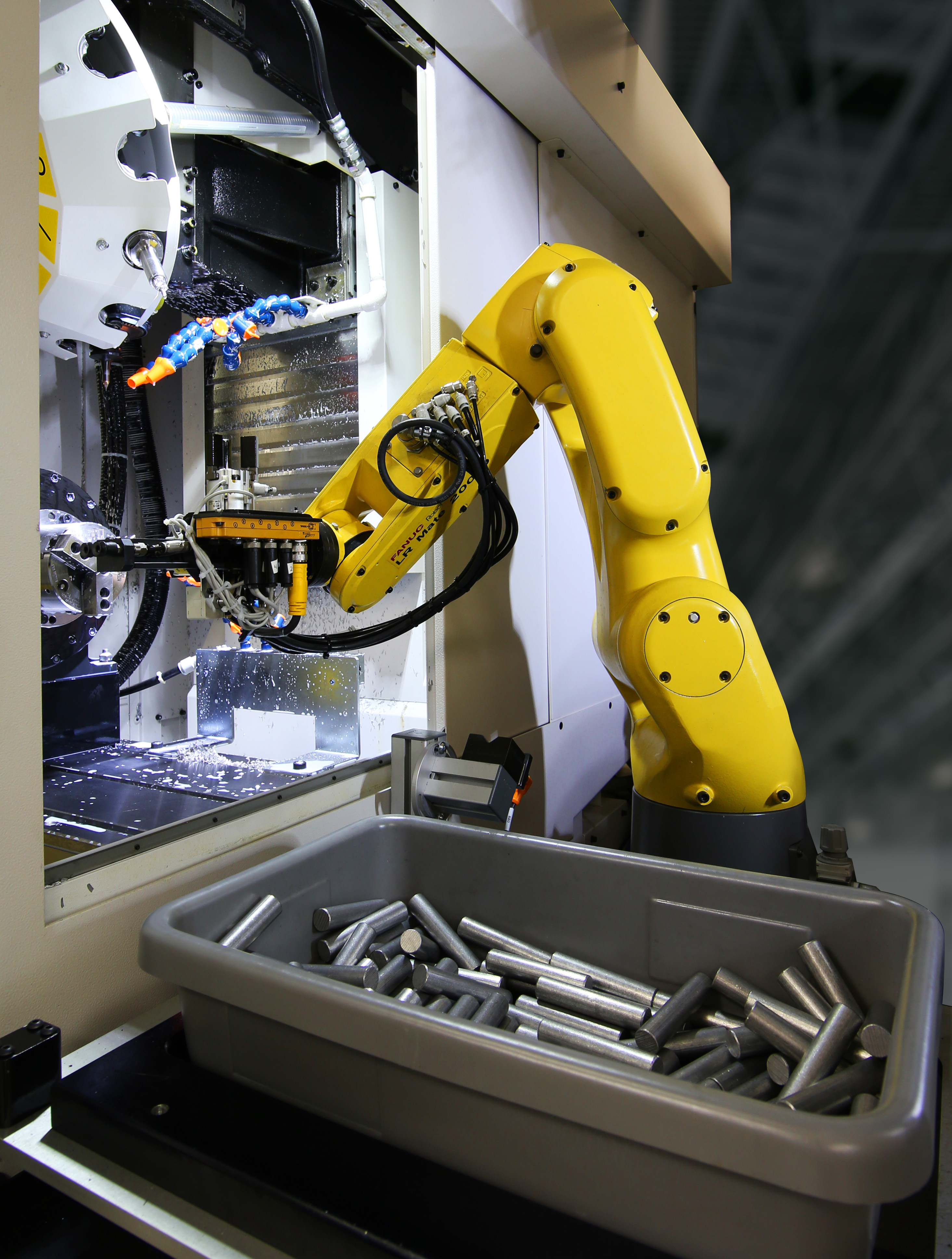

Machine Tending

Rocker Arm Machine Tending
FANUC LR Mate robot automates loading, unloading, and gauging of rocker arms, enabling continuous, precise, consistent operation.

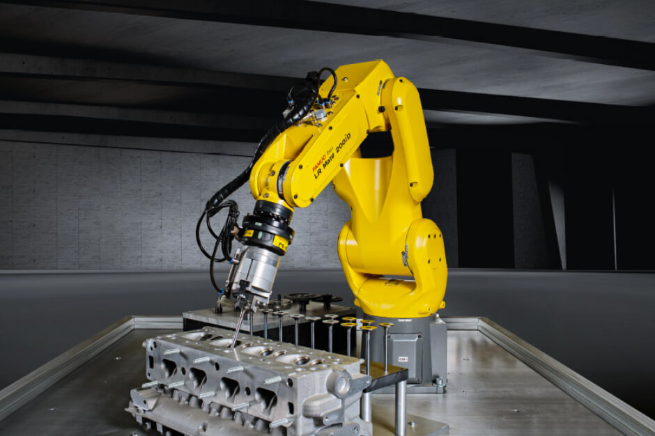

Die Sharpening
A FANUC LR Mate 200iD with force sensing sharpens dies through automated grinding and polishing, ensuring precise geometry and consistent, repeatable quality.

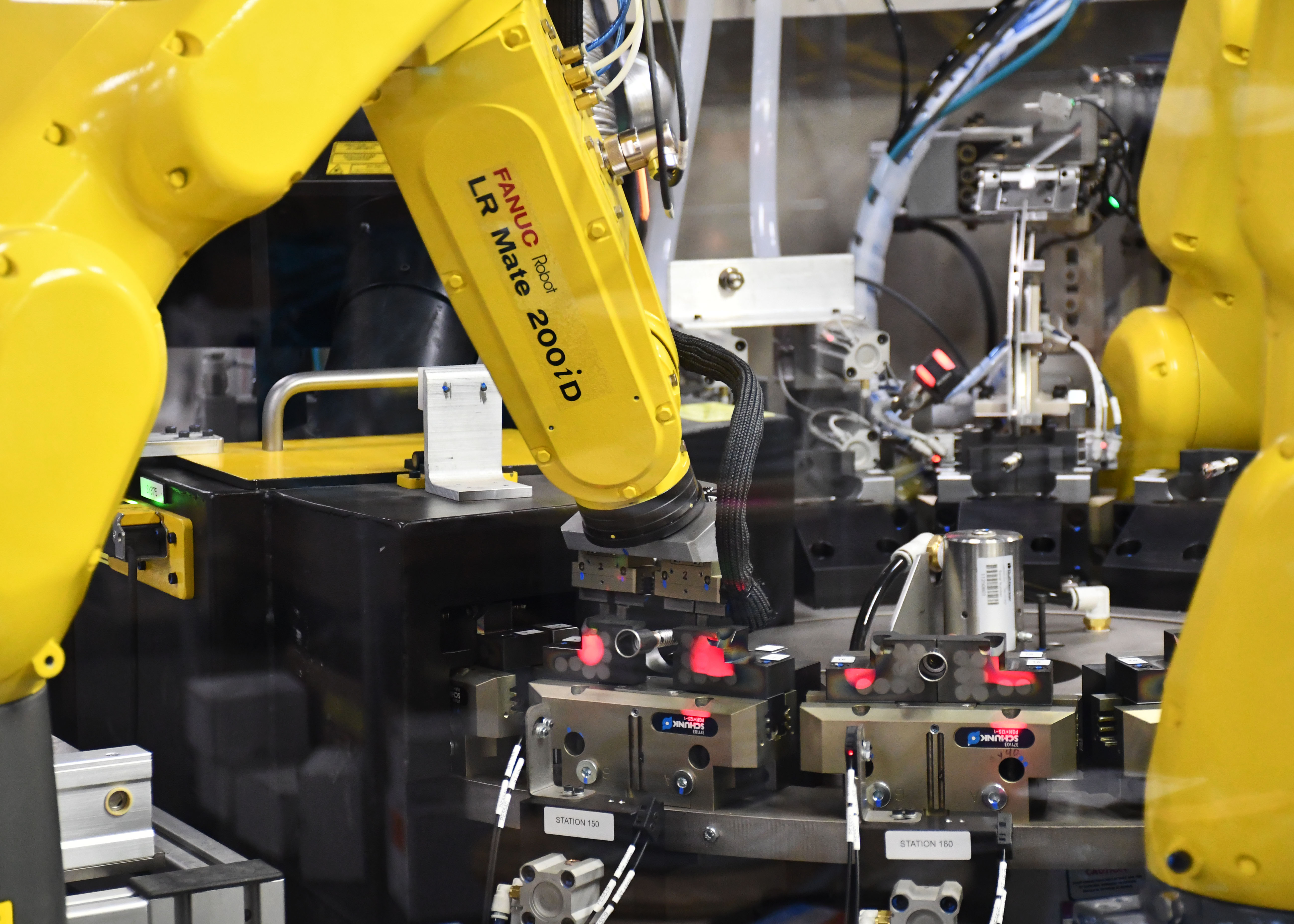

Multi-Axis Rotary Assembly Machine
FANUC SR‑3iA, SR‑6iA, and an LR Mate feed, place, screwdrive, and grommet‑insert parts on a rotary dial, automatically sorting finished assemblies.
