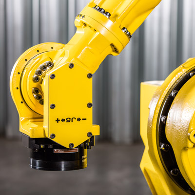

Combining speed with a wide work envelope, this model is ideally suited to high-speed transfer operations when fitted with a drive enhancement unit. Its compact design and slim wrist make it a great choice for handling operations where space is at a premium.

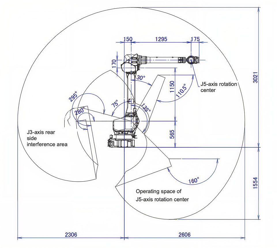

Increased work envelope
Offering that extra bit of reach, the long arm on this model makes it suited to handling pallets across a larger work area.

Compact design
The slim body and compact wrist provide maximum flexibility across a range of applications where space is an issue. Multi-direction operation is provided by a full 360 degrees of rotation from J1.

45 kg
±0.06 mm
2606 mm
570 kg
3 kW
360°
225°
440°
800°
800°
180°/s
180°/s
180°/s
250°/s
250°/s
360°/s
206/28
206/28
127/20
IP54 / IP67
