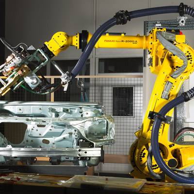

The FANUC R-2000iC/165F is ideally suited to high output automotive spot welding.
Fea ro ia r2000 spotweld 1

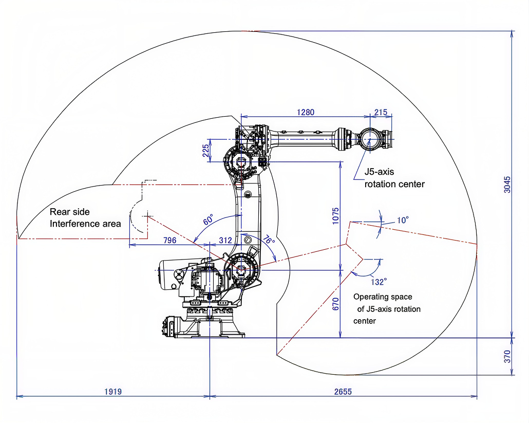

±0.05 mm
2655 mm
1090 kg
3 kW
370°
136°
312°
120°/s
105°/s
110°/s
140°/s
140°/s
220°/s
