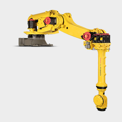

R-2000 Series
R-2000iC/165R
165 kg
3095 mm
1370 kg

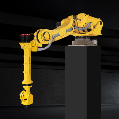

This rack-mounted model is ideal for increasing your productivity on shelf installations such as press, CNC machining and other machine tending applications. Its huge work envelope also means that it provides maximum flexibility on loading and unloading operations. As well as adding versatility to the robot, rack mounting also saves you valuable floor space.
Fea ro pr r2000165r l 2
Rack mount
If it needs to lift heavy payloads and be rack mounted, this is the model to go for.
Fea ro pr r2000165r r 1
Maximum work envelope
Save valuable floor space while benefitting from the flexibility of a huge 3095 mm working envelope.
