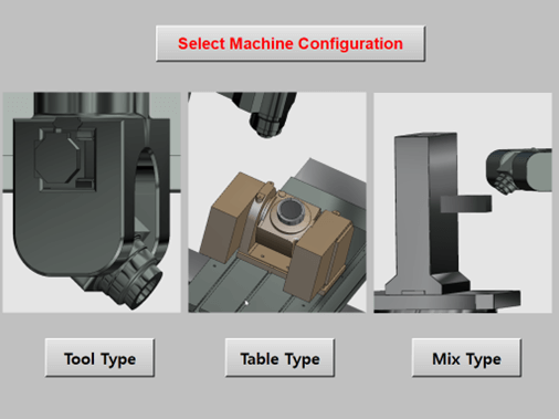

Want your machine tool to have house branded and unique screens? FANUC PICTURE enables the creation and display of customized HMI designs on the FANUC CNC screen. PICTURE projects can be easily imported and exported in a format executable directly by the CNC and displayed on the standard LCD screen without requiring additional PC display.

  • Supports different screen sizes and resolutions, touch screens, including virtual keypads, multi-language HMI applications and more
