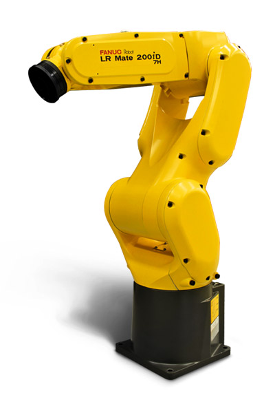

LR Mate 200iD/7H
7 kg
717 mm
5
24 kg
This super compact 5 axis robot is easy to integrate into confined spaces. Like all LR Mate robots, it is also available with a range of options including integrated intelligent (vision & force sensing) functionality, special application packages and full IP69K protection.
A Cost-effective 5-axis Robot
Ideal for high-speed applications that require the additional flexibility of a 5th axis.
