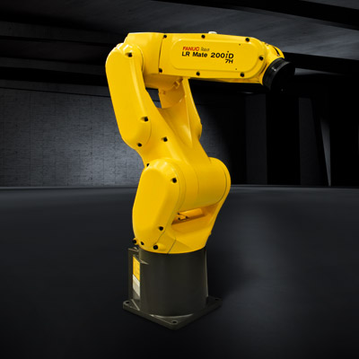

LR Mate Series
LR Mate 200iD/7H
7 kg
717 mm
5
24 kg
This super compact 5 axis robot is easy to integrate into confined spaces. Like all LR Mate robots, it is also available with a range of options including integrated intelligent (vision & force sensing) functionality, special application packages and full IP69K protection.

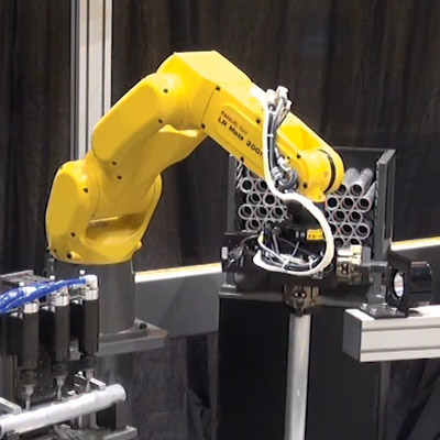

A Cost-effective 5-axis Robot
Ideal for high-speed applications that require the additional flexibility of a 5th axis.

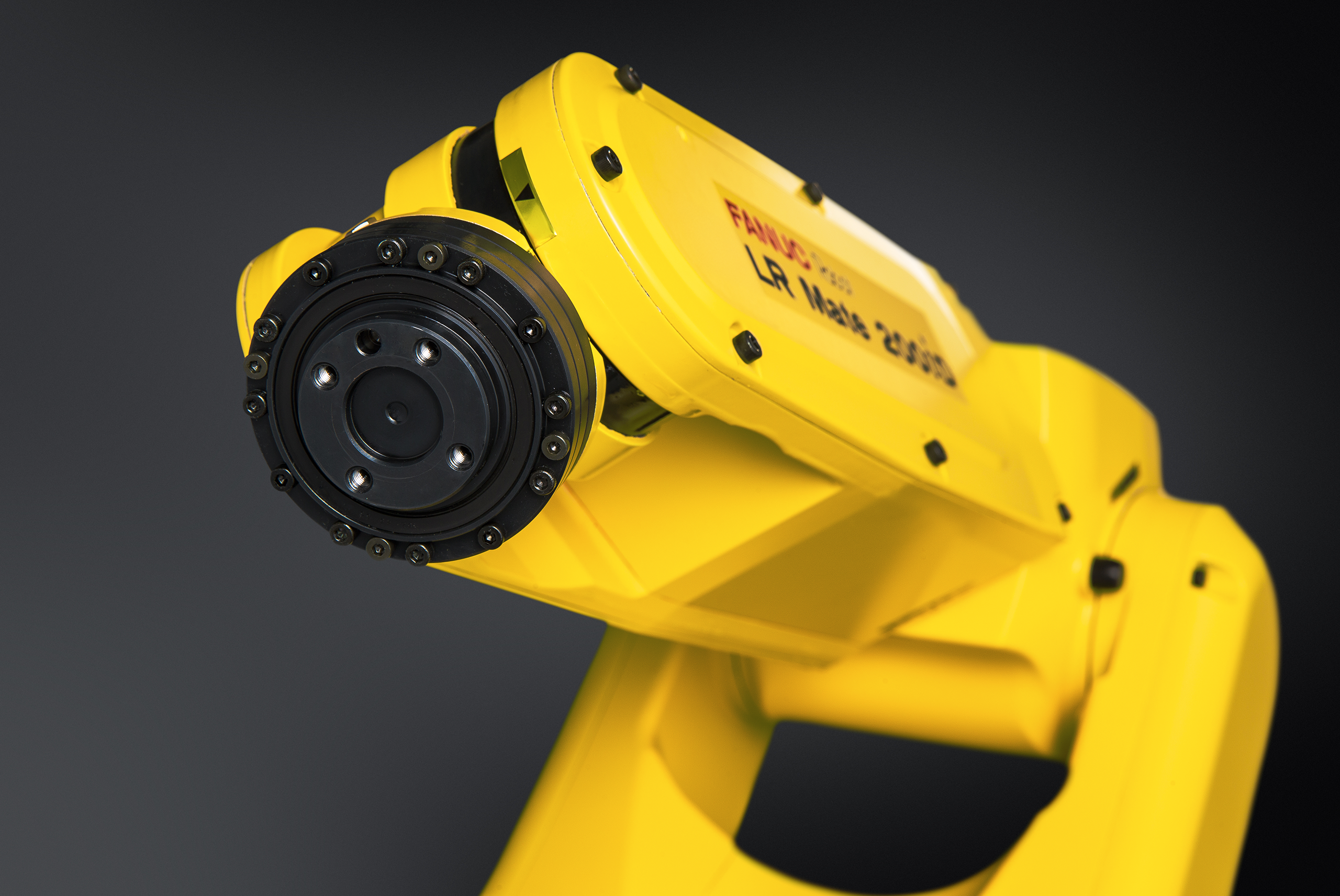

Lr mate 200id 7h deburring
High-speed Deburring
Fast and versatile, LR Mate 200iD/7H can perform robotic deburring and other material removal tasks accurately, and at very high speeds.
Lr mate 200id 7h facing right

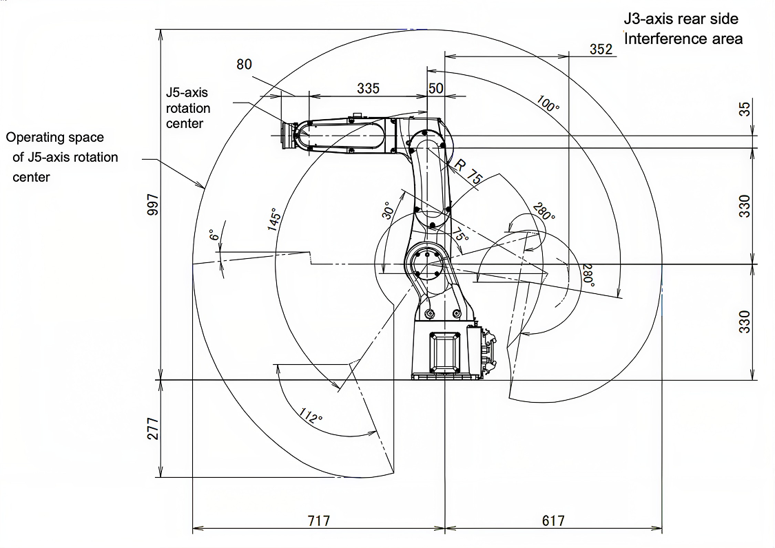

5
7 kg
±0.01 mm
717 mm
24 kg
0.5 kW
340°
245°
420°
450°/s
380°/s
520°/s
545°/s
1500°/s
16.6/.47
4/.046
IP67 / IP69K
IP67 / IP69K
