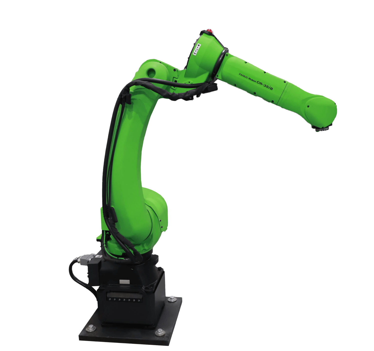

Meet the CR-35iB cobot, the industry's strongest cobot with a payload of up to 50kg, capable of working alongside operators in various applications that typically require lift-assist devices or custom equipment.
Despite not being part of the CRX series, the CR-35iB features a large work envelope and a small installation footprint, making it ideal for some of the same tight spaces that the rest of the CRX line would work well within. This lighter, streamlined mechanical unit integrates FANUC's newest safety sensor technology while retaining the simple programming synonymous with the CRX series.

More range of motion
A larger range of motion means even more flexibility and dexterity for various applications, including vision-guided picking or inspection, material handling, part transfer, machine tending, packing, palletizing, and more. Also, a hollow arm design minimizes interference with peripheral equipment. Whatever the task, if it has a heavy payload that also requires close interaction with workers, the CR-35iB is a great fit.

The strongest in the industry
FANUC CR‑35iB is the strongest collaborative robot, offering up to 50 kg payload, a large work envelope and a compact footprint ideal for tight spaces.
Object recognition ready
Depending on your needs, the CR-35iB can be equipped with a FANUC Vision Sensor or a FANUC 3D Area Sensor, enabling it to locate or visualize products.
Easy to program
CR‑35iB requires no special programming, offering intuitive setup via FANUC Hand Guidance or a tablet teach pendant with easy drag‑and‑drop interface.
