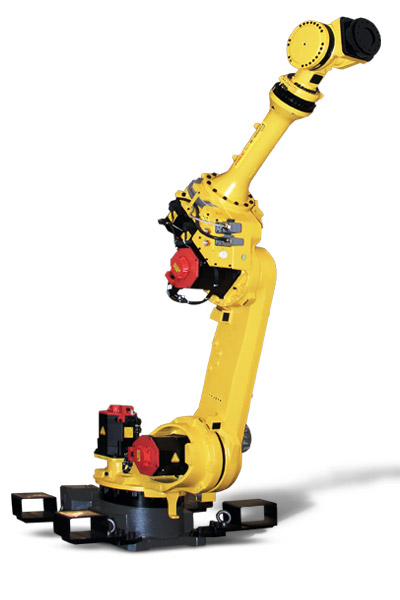

R-1000 Series
R-1000iA/100F
100 kg
2230 mm
665 kg
This 6 axis robot has the inherent flexibility to complete any number of challenging jobs. Very fast and capable of reaching excellent cycle times, it is particularly suited to a wide range of high-speed robotic spot welding applications. Compact and lightweight, it also saves you space.
Fea ro ia r1000 spotweld 2
The spot welding specialist
Maximize the productivity of your applications with payloads of up to 100 kg.
Fea ro pr r100080f r 1
Proven reliability and design
This model requires minimal maintenance and is extremely cost-effective when installing and operating it.
Fea ro ia r1000 spotweld 1
Additional versatility
This model is in favor of greater versatility – it can be mounted both on the ground as well as in a hanging position.
