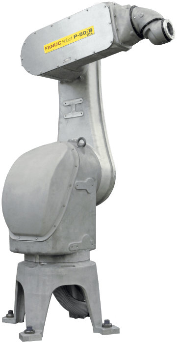

P-50iB/10L
10 kg
1800 mm
364 kg
Ultra compact, this high reach paint robot provides a reliable and precise painting and coating solution for a huge range of industries. An affordable choice, it benefits from a long reach and internal cabling.
P50ib 10l paint robot long arm banner
Long Arm Design
With a handling capacity of 10 kg and an extended reach of up to 1,800 mm, this precise and affordable model is the ideal painting and coating solution for almost any industry.
P50ib 10l paint robot hollow wrist banner
Patented Hollow Wrist
Inner diameter of 68 mm from J4 to J6 arm to achieve top product quality by eliminating contamination from debris falling from exposed paint hoses.
