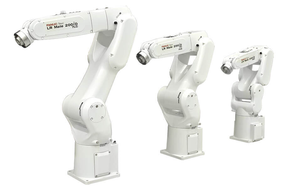

The FANUC LR Mate 200iD/4SC is a compact 6-axis clean room robot designed for higher speed applications that happen in clean room or food processing facilities. Our clean room robots were built to meet the standard requirements (IP67 standard) of highly demanding pharmacy and lab environments, and well as food and beverage handling applications - with no compromise of robot speed and repeatability.

Need a clean room robot with more payload or reach? We have options, including our LR Mate 200iD/7C and LR Mate 200iD/7LC long-arm version - both with a 7 kg payload and longer reach. Based on a slim, entirely encapsulated design, our clean room robots reach high flexibility levels, adding versatility to their ability to perform many types of clean room applications within compact cells.
