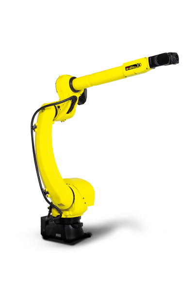

M-20 Series
M-20iD/12L
12 kg
2272 mm
250 kg
Designed specifically for handling applications, this model features outstanding axis speeds and ultimate precision within its class. The highly versatile robot can handle large parts thanks to its very long horizontal stroke. To further maximize flexibility and open up a new range of manufacturing application possibilities, it can also carry additional tools weighing up to 12 kg.
Smart offline programming
M20id35
Large hollow wrist
To prevent the risk of snagging and cable wear, all cables can be routed through the robot’s large 57 mm diameter hollow wrist and hollow arm.
Co ge 3dh zdt button 400x400
Zero Down Time
Intelligent FANUC Zero Down Time (ZDT) software for intelligent maintenance prediction and scheduling.
12 kg
±0.03 mm
2272 mm
250 kg
1 kW
340°
260°
475°
400°
360°
900°
210°/s
210°/s
265°/s
420°/s
450°/s
720°/s
22/.65
22/.65
9.8/.17
IP54 / IP65
