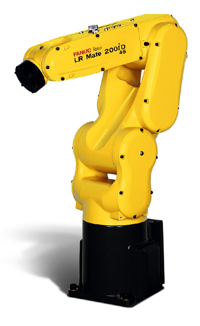

LR Mate Series
LR Mate 200iD/4S
4 kg
550 mm
20 kg
Extremely compact, this 6-axis short arm robot has been designed for confined spaces and compact machines. Easy to integrate, this model is also available with a range of options including integrated intelligent (robotic vision & force sensing) functionality, and special application packages.
The lightest model in the LR Mate range
At only 20 kg, this model can be installed almost anywhere. With its slim arm and compact design, along with cabling through the arm and wrist, the LR Mate 200iD/4S is the ideal solution for very confined spaces.
LR Mate 200i D 4 S Material Handling Close Up
Fast Handling
Designed to handle small payloads of 4 kg or less at very high speeds makes this robot an excellent fit for applications that require high throughput rates, such as robotic machine tending, robotic pick and place, and robotic part transfer.

Compatible Controllers
4 kg
±0.01 mm
550 mm
20 kg
0.5 kW
340°
230°
402°
380°
240°
460°/s
460°/s
520°/s
560°/s
560°/s
900°/s
8.86/0.2
8.86/0.2
4.9/0.067
R-30iB Plus Mate Cabinet
