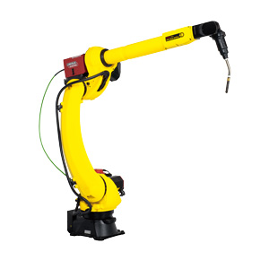

ARC Mate 120iD/12L
12 kg
2272 mm
250 kg
Designed specifically for welding applications, this model features outstanding axis speeds and ultimate precision within its class. The highly versatile robot can weld large parts thanks to its very long horizontal stroke. To further maximize flexibility and open up a new range of application possibilities, it can carry additional tools and torches weighing up to 12 kg.
Longest Reach Model
For welding tasks where reach is of major concern, this long arm model offers the longest reach of the ARC Mate series with 2272 mm.
FANUC ARC Mate 100i D Welding
Protection class IP67
The extra smooth surfaces on the ARC Mate series help minimize spatter build up. IP67 protection on the wrist axes protect the robot against moisture and dust, making it the ideal candidate for dirty welding or cutting applications.
