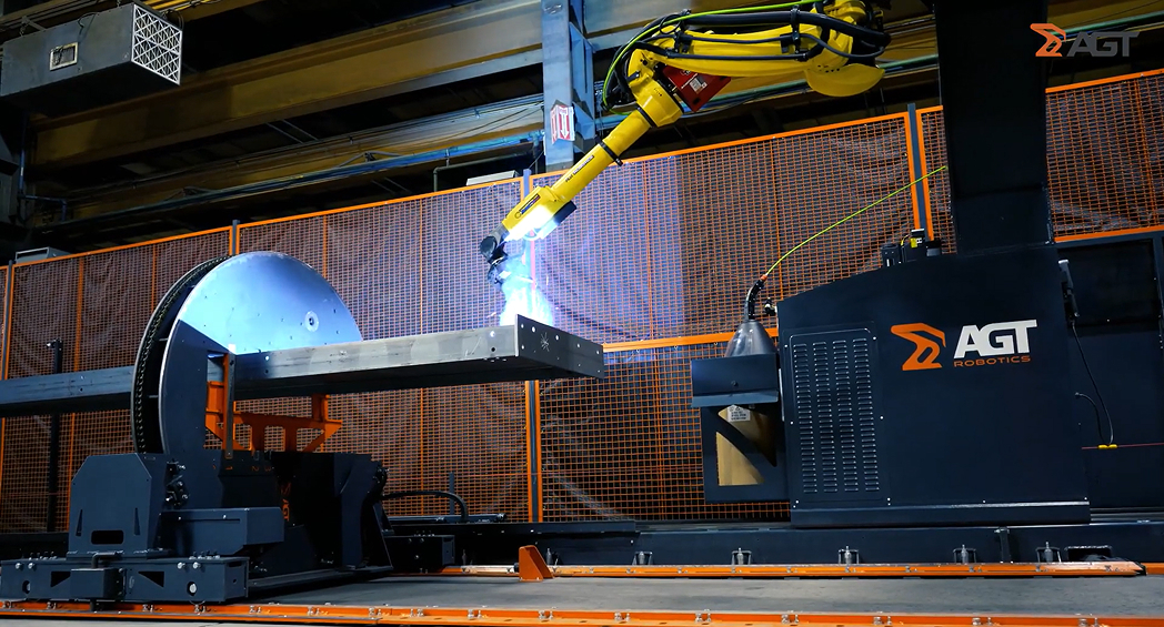

A yellow AGT Robotics welding arm performing arc welding on a large rectangular metal beam mounted on a rotating fixture, inside an orange-fenced industrial work cell.

Last year at the Fabtech tradeshow in Chicago, Steelway discovered AGT’s advanced robotic welding system, BeamMaster, a game-changing solution capable of rotating beams for full four-sided weld coverage. Impressed by the system’s capabilities, Steelway partnered with the FANUC Authorized System Integrator to bring the technology to their facility.
The goal: automate the welding of three-plate beams to increase output, reduce manual workload and optimize efficiency.
The results were immediate and measurable. The new system allowed Steelway to weld all four sides of a beam without manual repositioning, significantly speeding up production. Welders were redeployed to focus on finishing tasks, while the robot handled the bulk of repetitive welding.
“It’s better, easier to learn, and capable of more welding than our previous system,” said Randy Thiesen, a Steelway robotic weld cell coordinator.
Encouraged by the success of the new BeamMaster system, Steelway expanded by adding a second robot and extending the weld zone by 15 feet, which accommodates beams up to 60 feet long. This dual-zone setup enabled simultaneous welding of long and short beams, maximizing throughput and floor space utilization. The integration with Advanced Steel and Cortex software allowed seamless programming via IFC file exports, streamlining the transition from design to production.
