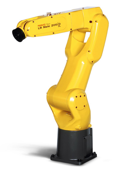

LR Mate Series
LR Mate 200iD/7L
7 kg
911 mm
27 kg
Fast at handling small payloads, this compact multi-purpose industrial robot offers an enhanced reach. Like all LR Mate robots, it is also available with a range of options including integrated intelligent (vision & force) functionality, special application packages and standard IP67 protection.
LR Mate 200iD/L picking comic books
The LR Mate Model with the Longest Reach
At 911 mm and payloads of up to 7 kg, this is the long reach LR Mate for a range of handling applications such as robotic machine tending and robotic picking and packaging.
Closeup LR Mate 200iD/L nameplate
Extra Flexibility
This high-speed robot includes 6 axes of motion and a longer reach capable of handling a broad range of products within a wide work envelope. It also includes better cable protection and durability, easier cleaning and maintenance, better system reliability and improved performance.
