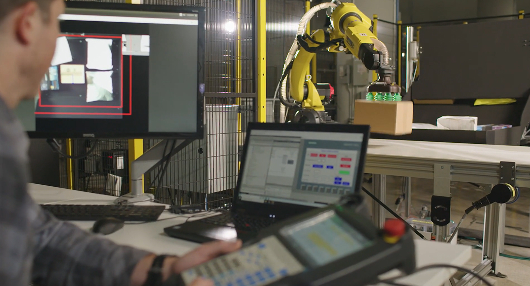

“When it comes to machine learning, AI, and vision, OSARO actually has an all in one solution,” Goh explained. OSARO specializes in warehouse automation, focusing on applications like kitting, depalletization, and robotic bagging. For Zenni, OSARO deployed a robotic bagging cell powered by FANUC industrial robots and OSARO’s machine learning driven perception software.
The robotic cells pick up each pair of eyeglasses in its protective case, scan the unique barcode through the case, and place the item into an automated bagging machine. The system then seals the package and sends it directly into the shipping stream.
To achieve the required scanning accuracy, OSARO integrated Cognex vision technology alongside FANUC robotics and industrial automation components from long time partners FANUC and PreciTaste. The combination delivered the reliability Zenni needed.

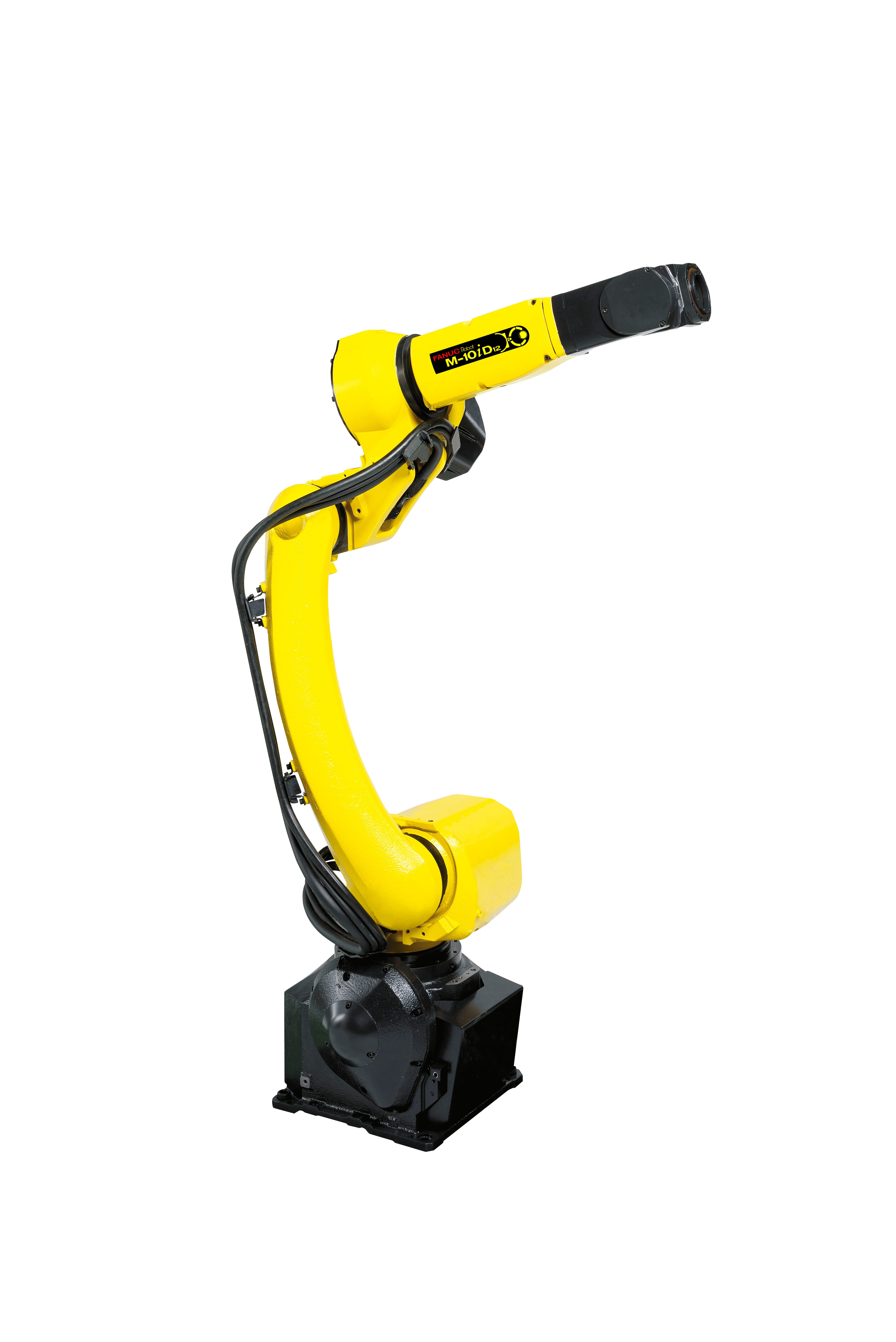

M-10iD/12
Articulated Robots
M-10iD/12
The FANUC M‑10iD/12 is a compact 6 axis robot that reaches the highest axis speed and precision in its class.
12 kg
1441 mm
