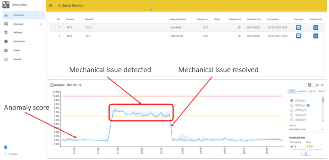

AI Servo Monitor automatically creates a baseline model of the machine while running in a normal state. An anomaly score produced expresses a difference in the baseline model and the daily recorded values. When this value exceeds the predefined thresholds, email notifications can be issued with warnings that some type of machine failure could be imminent.

  5. Easily monitor data: Through a web interface, authorized personnel can monitor the anomaly score displayed in intuitive graphs.
