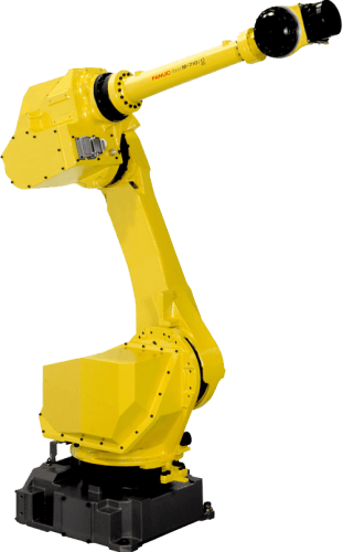

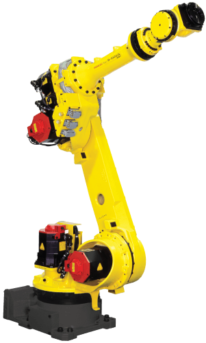

KAD Models has two Trinity automation cells, the AX5 and the AX4. The AX5 uses a FANUC M-710iC/50 robot, which has 50 kg payload and 2050 mm reach, and the AX4 uses a FANUC R-1000/100F robot, which has a 100 kg payload and 2230 mm reach, tending a Matsuura 5-axis CNC machining center.
