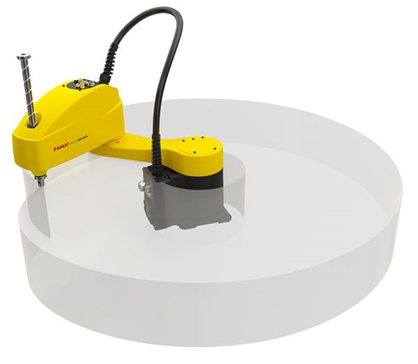

SCARA Robot - Work Envelope
The work envelope or the area of space that a robot can physically reach is a critical consideration. Whether SCARA, Delta Robots, or six-axis robots, the lengths of various links, and the limitations of the joint motion are important factors to review.
Typically, SCARA robots have a cylindrical shaped work envelope with variations in the diameter and depth of the cylinder. The total lengths of arms one and two define the diameter of the circle, while the Z stroke defines the depth of the cylinder. (See FANUC SCARA Work Envelope)
FANUC-SCARA-Work-Envelope
FANUC SR Series SCARA Robot Work Envelope
In most applications, a SCARA’s work envelope is contained to the front and side. The back area may not be useable if cables and pneumatic hoses exit from the rear - some SCARAs offer optional bottom exits – making it possible to work behind the robot.
