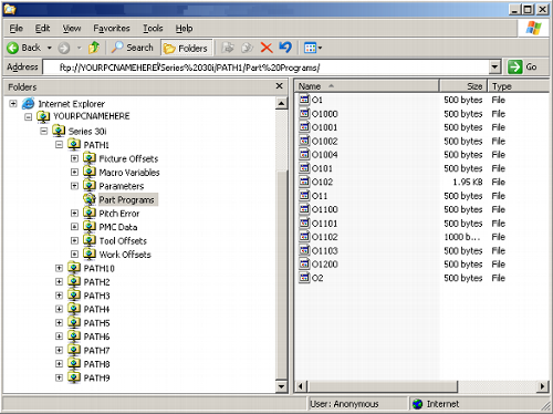

FANUC FASConnect (FOCAS Automation Solution Connect)
FASConnect is Windows software that allows you to manage all the data in FANUC controls from any location on the network. FASConnect is a Windows Service that is installed on any PC on the network and allows you to drag and drop files between a PC and the CNC using standard software like Windows Explorer.
FASConnect Screen
Click to view enlarged image
Practically all CNC data can be transferred, depending on CNC type:
  • Part programs
  • Tool offsets
  • Fixture offsets
  • Parameters
  • Macro variables
  • PMC data
  • Pitch error data
  • User files in FROM
  • SRAM backup
