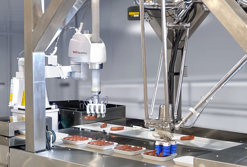

    This demo shows the DR-3iB/6 Stainless IP69K-rated delta robot and a food-grade SR-12iA/C SCARA robot placing sausage links in packages. Driven by USDA and FDA sanitation standards, the system uses vacuum grippers and FANUC’s iRPickTool for accurate placement in high-pressure washdown environments.
