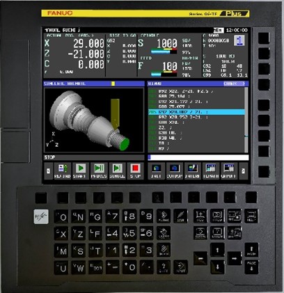

FANUC CNC Controls 0i MF Plus
0i-MF Plus
FANUC 0i-MF Plus CNC delivers efficient, high-quality milling with reduced cycle times, smooth surface finishes, customizable functions, and flexible HMI.
