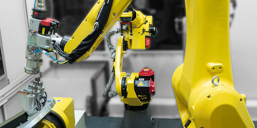

Each of these diverse application areas are being absorbed as a whole across the automation discipline. It’s these various advancements that have allowed manufacturers to mount a laser to a robot and perform welding or cutting with extreme precision and versatility.

In a market that has been traditionally dominated by CNC controlled heads, robotically positioned laser welding and cutting is starting to gain market share as a result of the above mentioned advancements and, not surprisingly, by the flexibility of having a robot-carried processing head.
This means six degrees of freedom are possible, which allows the user to break away from the flat plate limitations of an X-Y table and explore processing 3-D parts in 3-D space. This could be circular or square tubing or it could be part of an assembly like the inside of a truck frame.
Additionally, if auxiliary motors or another robot are used to manipulate the part, access within complex geometries is made easier by positioning the part and the robot into an optimum location. This also promotes the ability of coordinating the motion between the part and the robot so that the process can continue uninterrupted.
Another benefit of using a robot-carried head is the ability to change out the end-of-arm tooling between a welding head and a cutting head or change from a welding head to a pressure-driven grinding or polishing device for post-weld processing. This minimizes the real estate required on the expensive factory floor by not having individually dedicated processes.
