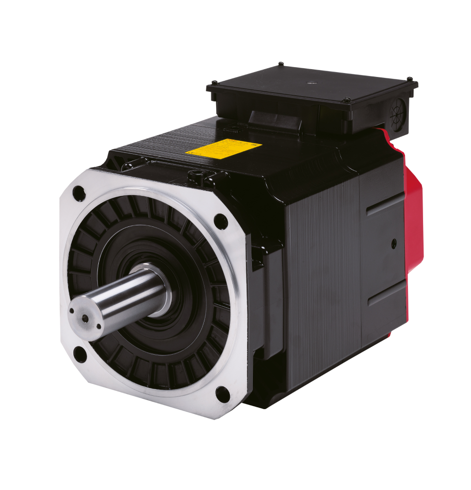

A conventional servo motor converts electrical energy into rotational motion. To do this, a servo motor usually consists of a stator, which acts as the housing, a permanent magnet rotor and a feedback device.
The servo motor is secured to the frame of a machine or load that is to be controlled. The stator comprises the motor’s electromagnetic feature.  When electrical current flows through its copper windings, a portion of the stator body can be made magnetically attractive to the rotor.
The rotor is the rotating part of the motor that is coupled to the load. It is made of an output shaft that is centered in an iron mass constructed of steel laminates. The rotor is suspended by a pair of bearings holding the output shaft in the center of the stator. The rotor’s magnetic field is made of permanent magnets that are embedded in the rotor.

FANUC servo motor
FANUC servo motor

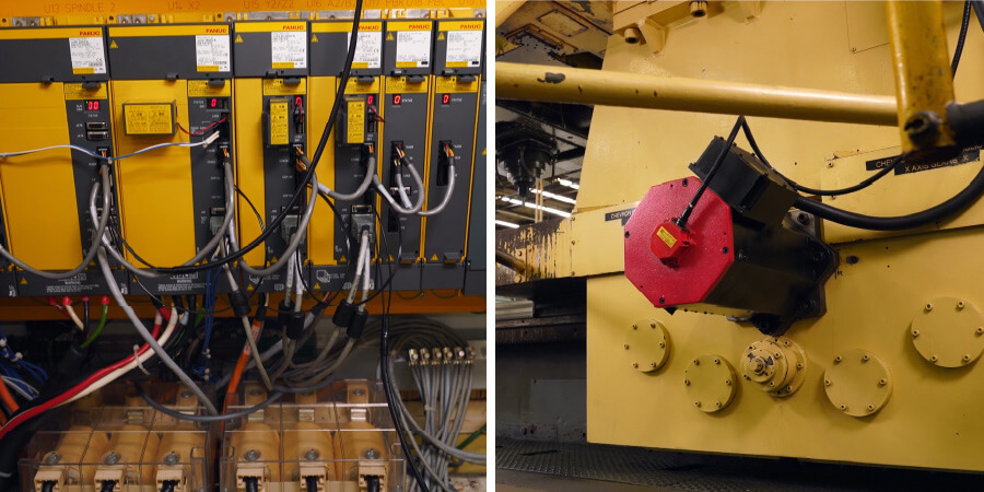

Flexibility on your motors’ location: Often times, motors are placed directly under machinery. However, that might not be the best place for motors to ensure they perform as needed and live up to their longest lifespan.  Even though points one and two hit on waterproofing, if you can avoid putting your equipment where it’s going to get wet all the time, do it!  Liquid has a maddening tendency to find its way in to exactly where you don’t want it, if you can avoid getting your motors wet at all, that’s the best plan.
Coolant is usually a necessary evil:  A lot of maintenance is associated with coolant, but not performing these activities correctly can result in some nasty science experiments.  Maintaining the proper pH and aeration levels goes a long way toward keeping coolant from turning caustic and then eating away at protective materials such as paint and rubber.  If your coolant smells like a stray cat has moved into the area, you can know that the bacteria level is way too high.
