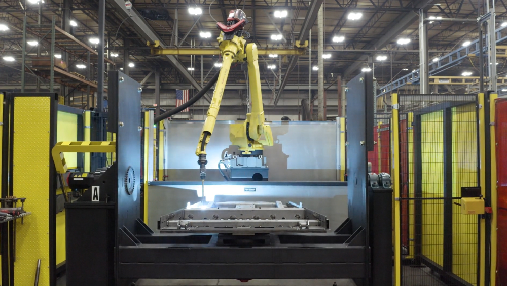

The Will-Burt Co. is an international OEM serving many different industries including defense, telecommunications, energy production and more. The campus in Orville, Ohio has over 250,000 square feet of manufacturing and assembly space. Part of the manufacturing activities done here is fabrication of sheet metal used by heavy machinery companies such as Caterpillar and JLG. Located in a rural area, the company was challenged with finding skilled welders and the welder shortage was affecting the company’s ability to take on additional work.
The company went from a manual welding process to an automated robotic arc welding system, integrated by Weldbot, using a FANUC M-710iC/12L robot for their large parts first in 2020 and added another automated system using a FANUC ARC Mate 100iD/8L robot. Will-Burt found that the robots were on average 3 to 4 times more efficient than manual welding, plus yielded better welding quality. For every robotic system added, it has allowed an extra 240 to 320 additional hours of welding per week or approximately $4 million of contract fabrication work. The extra capacity and capabilities allow the facility to control costs, keeping the company competitive while improving the quality of the parts produced.
Future automation projects include automating their CNC machine tending as well as adding another automated robotic welding solution.

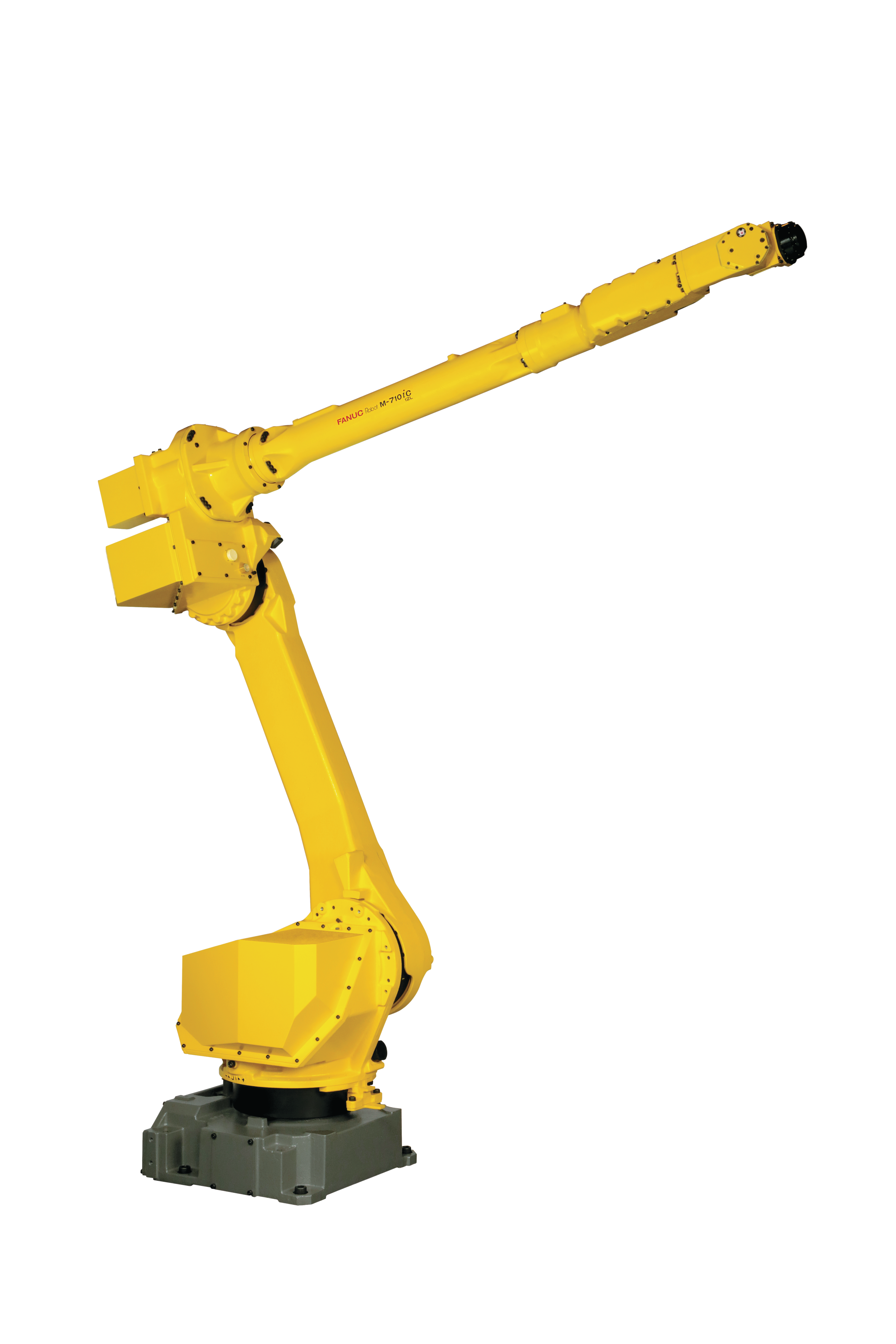

M-710iC/12L
The FANUC M‑710iC/12L is a small to medium payload 6‑axis robot model ideal for all applications to handle medium payloads for up to 12 kg.
12 kg
3123 mm
View M-710iC/12L

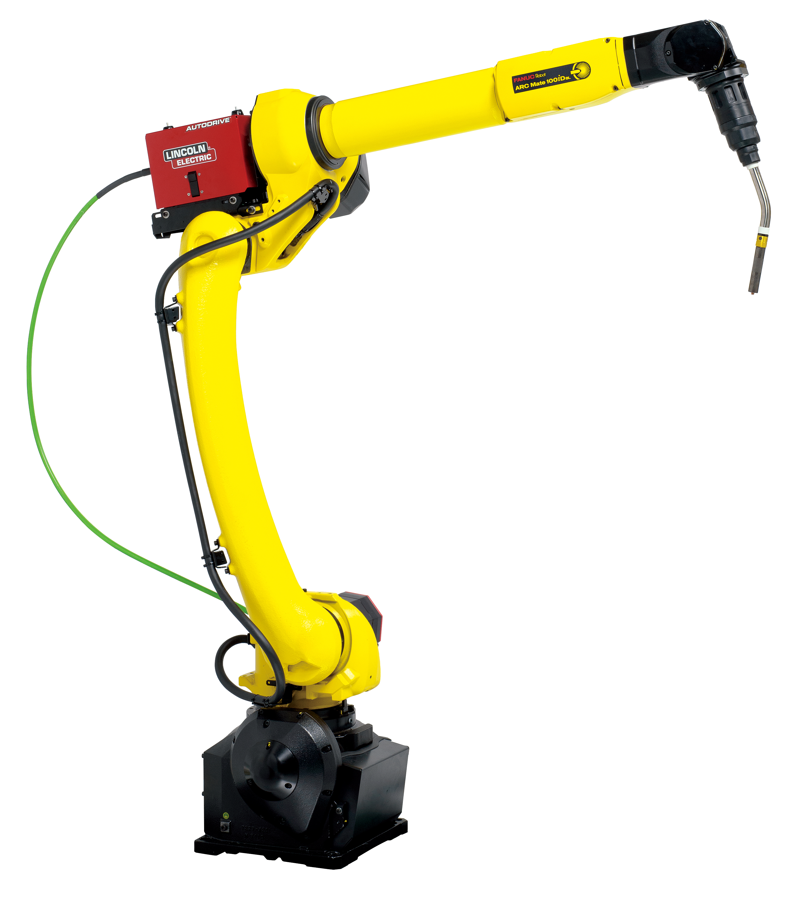

ARC Mate 100iD/8L
Long-arm arc welding robot ideally suited for working in compact robotic cells where extra reach is required for welding.
8 kg
2032 mm
View ARC Mate 100iD/8L
