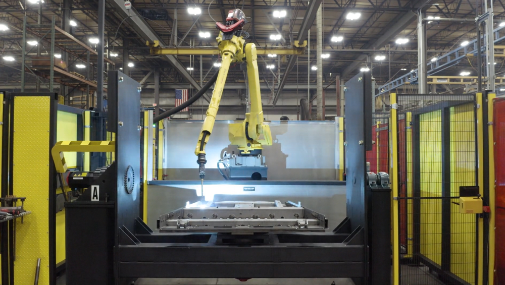

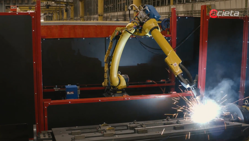

Ideally suited for working in compact robotic cells, the slimline ARC Mate 100iD/8L occupies a small footprint and can be installed upside down or angle mounted for even more flexibility. The long-arm arc welding robot comes with a fully integrated hose pack and cable management system. For easy and reliable routing of sensor or camera cables, air pipes and other utilities, services are routed through the robot’s hollow arm, wrist and body.
FANUC ARC Mate 100i D Welding
Ideal for Compact Installation Requirements
This arc welder allows for easy routing of the welding dressout and seam tracking sensor cables throughout the robot. It eliminates robot interference with peripherals and work cell equipment, improving the overall system reliability and ease of use.
Dual ARC Mate 100i D LR Mate 200i D
Hollow Wrist for High-Density Layouts
The torch hosepack as well as additional utilities such as seam tracking sensor cables, vision cables, or air pipes, are routed through its hollow arm and wrist, enabling it to fully articulate to reach narrow spaces in jigs and tight fixtures. This Arc Welding robot features one of the largest hollow wrist in its class with 57mm.

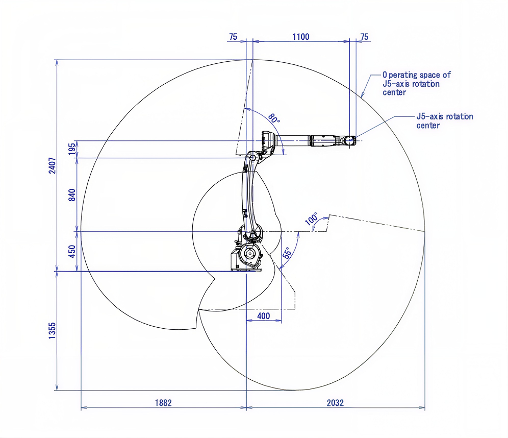

8 kg
Floor / Angle
±0.03 mm
2032 mm
180 kg
1 kW
340°
235°
455°
380°
360°
900°
210°/s
210°/s
265°/s
400°/s
420°/s
720°/s
16.1/.63
16.1/.63
5.9/.061
IP54 / IP55
