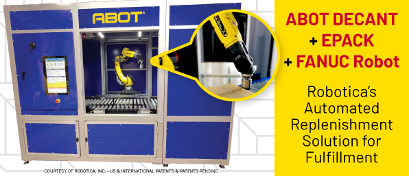

Robotica’s industry leading second-generation ABOTm-1 for automated decant is a natural progression following years of experience designing and producing multiple commercialized automated box opening technologies.  Now, the ABOTm-1 uses data elements to successfully open boxes without damaging the inner pack contents.  Generation one systems required an operator to input data for various packages, and used a manual database to maintain the information.  However, it quickly became clear that a manual database would not be effective for many eCommerce warehouses that process tens of thousands of SKUs with constantly changing packages and shipping cartons.  Plus, in today’s fast-moving distribution culture, maintaining a manual database with this magnitude is far too labor intensive and time consuming.
The ABOT Generation II uses autonomous learning of box dimensions and cutting metrics. This method provides effective data management, and the ability to accurately open an ever-expanding range of box sizes and configurations while protecting the inner packs.  The AI module allows for continuous learning and improvement that can be shared across multiple ABOTm-1 machines in a network.
ABOT + ePack - The Ideal Decant System Solution – Features & Benefits
The combination of ABOTm-1 box opening with decant and a FANUC robot into ePack technology is offered in two standard modular production models for quick delivery and installation.  ABOT+ ePack systems are easily configured and integrated into micro-fulfillment and large DC applications. For example, a single ePack-Micro processes up to 400 shipping cases per hour, and a single ePack-DC handles up to 800 cases per hour.  Higher volumes are achieved using multiple cells, and options include automated receiving, de-palletizing, dimensioning, weighing and scanning.
Robotica’s decant automation can be integrated with robotic material movement or an existing conveyor.  The ePack technology simplifies material movement for decant. Replenishment supply (donor cases) and order inventory (totes) can be handled, buffered, and managed.
The ePack systems easily interface with various AMR or goods-to-operator robotics without special programming or interface equipment. In addition, ePack is adept at receiving and delivering inventory totes to and from static shelf positions or onto a takeaway conveyor.  And, ePack can access totes randomly for buffering, SKU matching and/or compartment matching.
Pre-programming ePack for specific SKUs or item shapes and case sizes is not required. First time cases and contents are automatically handled based on rules constantly fine-tuned by ePack’s AI.
Multiple caseloads of inner pack unit items can be placed in a tote or sub-compartment using ePack’s volumetric efficiency, which automatically matches sub-compartment sizes with the unit batch size.  The ability to consolidate items helps replenish partially filled totes; ePack can create empty spaces or voids with partially filled, randomly located items in a destination tote and then fill the void created with additional replenishment inner pack items.
ePack automatically handles an extremely wide range of unit shapes, sizes and packaging including cans, bottles, free form shapes and blister packs. Orientation of unit items is variable based on best fit or overridden (top of unit up) for items prone to leaking. Glass items and fragile unit items are loaded gently. Empty shipping cases and tops are automatically transferred to recycling.
