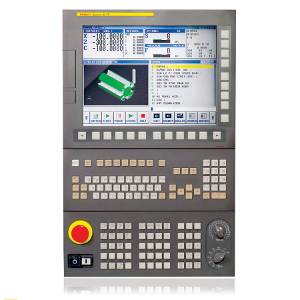

The 0iF-Model F has offered up fast, accurate performance for a wide range of applications including milling, turning, punching and grinding. For the latest generation of this series, check out the 0i-MODEL F Plus.

FANUC CNC Series 0i-MF for CNC Milling
Advanced machining cycles and features associated with high-speed machining of complex surfaces.

FANUC CNC Series 0i-TF for CNC Turning
Turning centers benefit from advanced turning cycles and integrated milling using a spindle c-axis or independent y-axis and live tooling.
