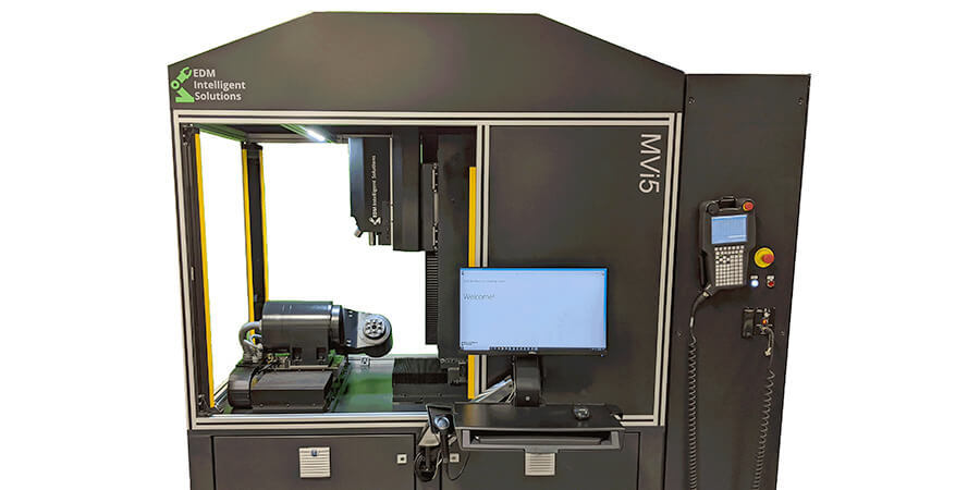

EDM Intelligent Solutions’ (EDMIS) customers needed an improved non-contact vision inspection system that would have greater functionality and increased ease of use. To meet this need, EDMIS developed a 5-axis automated 3D metrology center, the MVi5, which uses non-contact sensors to capture measurements and determine surface finish in the specified Ra, or the measurement of the surface’s average absolute deviation from its mean height. Additional surface finish metrics like Rq, Rt, Rz, Rmax and Sa parameters are also available.
When a workpiece is loaded into the MVi5, the system captures 3D point data of the part and generates automated form, roughness and dimensional measurements. The part’s datums are also captured and used to produce measurements in the part coordinate system which allows for 3D and 2D true position measurements of the part. Advanced 3D metrology sensors featuring measurement speeds of up to ≤ 1.7 million points per second and high-resolutions of 10nm allow the MVi5 to measure form, distance, height, surface roughness, true position, scan vs. CAD model differences and scan vs. scan differences all in one rugged multi-sensor platform that is ready to be installed directly on the manufacturing production floor.
Using the EDMISi measurement programming environment, customized 3D model-based measurement and inspection programs are automatically generated off the 3D solid model design of the part to be inspected, simplifying traditionally complex programming of measurement and inspection tasks. Offline measurement and inspection programming is also offered through integration with various CAD/CAM software packages common within industry.

EDMIS was familiar with FANUC because the company had already incorporated 6-axis FANUC robot arms for its robotic measurement system, the RSH-M10. Their end users were already comfortable with using the FANUC robot interface and FANUC’s Power Motion i-MODEL A controls have a very similar look and feel.
“We wanted the metrology center to be very easy to operate,” says Zic. Indeed, operation of the MVi5 5-Axis 3D Metrology Center is quick and simple via the touch screen optimized EDMISi human machine interface with native barcode compatibility.
In addition, FANUC’s Power Motion i-MODEL A has a broad range of customizable solutions, including integrated LCD screens and sophisticated handheld displays that are ideal for even novice operators. Zic was also concerned about his customers having to regularly update a PC-based type of control, which is not a problem with CNCs.
Another feature that sets the MVi5 apart from other metrology systems is its ability to be located directly on the production floor. Most metrology and surface measurement equipment need to be placed in a separate temperature controller clean area away from production machinery. The MVi5, on the other hand, is not as temperature sensitive as other metrology systems. The industrial machine tool base houses a top of the line motion system with linear travels of 300mm on the X, Y and Z axes along with integrated glass scales on each. The heavy-duty rotation and tilt unit features a payload of 20kg with a B-Axis tilt range of +/-120° and continuous C-Axis rotation of 360°, with both axes having integrated absolute encoders.
