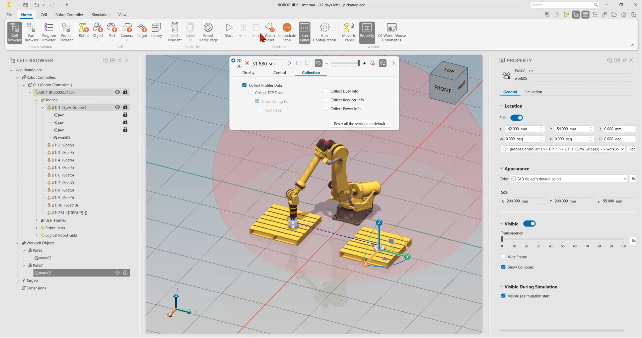

ROBOGUIDE V10 Overview: What The Software Actually Does
ROBOGUIDE V10 brings offline robot programming and full 3D simulation into a single workflow. Engineers build the robot program on a PC, then run that program inside a digital version of the production cell. The software mirrors real controller behavior, motion logic, and configuration, so the simulation reflects what the robot will do on the floor.
Inside ROBOGUIDE V10, a “workcell” means the entire system: robot model, virtual controller, fixtures, end-of-arm tooling, defined safety zones, conveyors, and the parts that move through the process. Users import CAD models, place equipment in relation to each other, set frames, and validate motion paths.
In response to growing demand for easier integration, FANUC America has also enhanced ROBOGUIDE simulation software to simplify connectivity with Rockwell Automation’s FactoryTalk® Logix Echo.
FANUC ROBOGUIDE software gives teams a controlled environment to test cycle time, reach limits, interference risk, and layout changes. In practice, ROBOGUIDE v10 becomes the proving ground before hardware arrives at the plant.
ROBOGUIDE V10 Workcell
ROBOGUIDE V10 material handling workcell

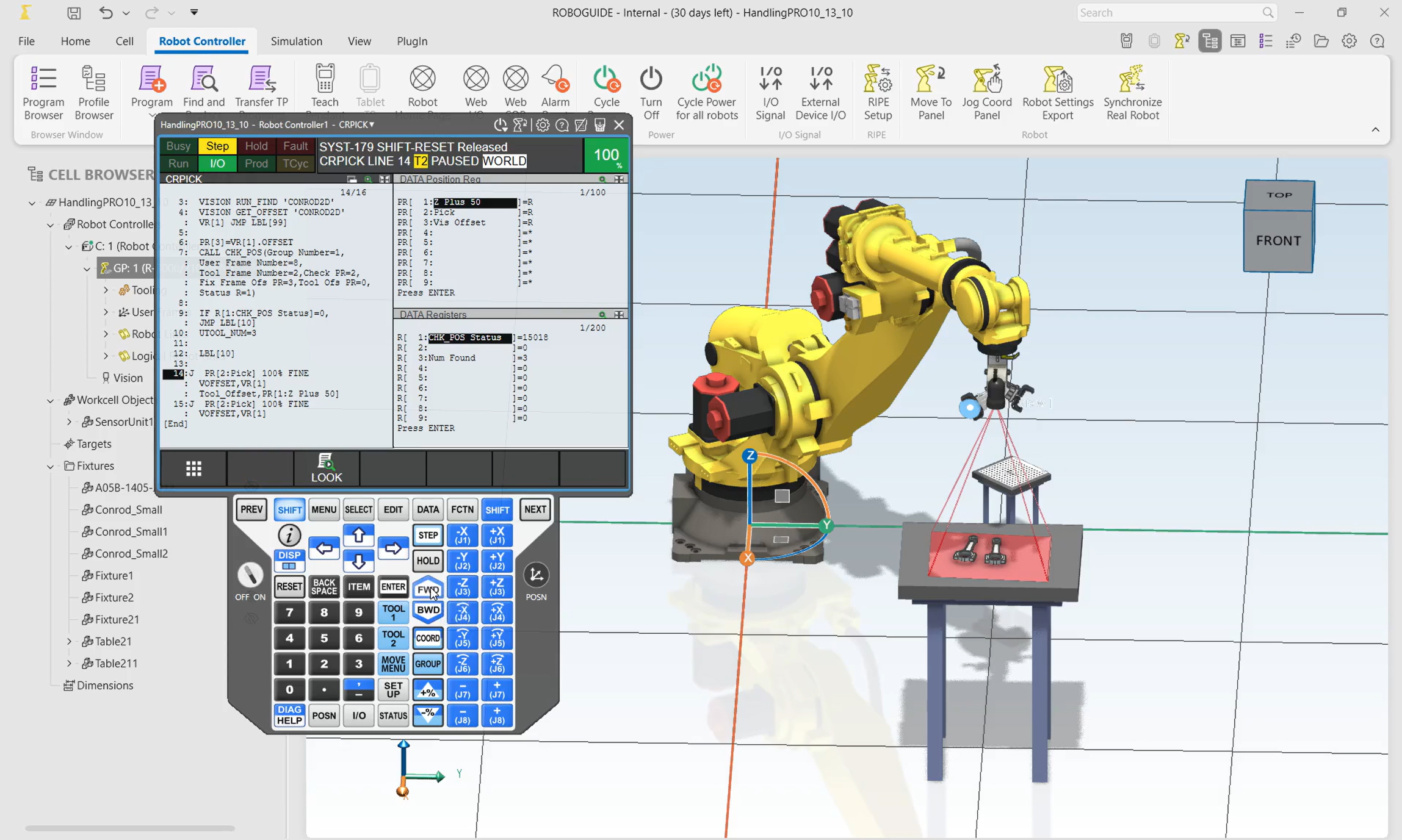

Graphics In V10: Depth Perception, Lighting, And Why It Helps Engineers
ROBOGUIDE V10 delivers high-quality rendering with advanced lighting, shadows, reflections, and modern shading techniques. The 3D workcell looks more like a real production space than a wireframe concept. Depth perception improves. Clearances look real. Tooling edges and guarding surfaces show up with definition that makes spatial judgment easier.
That visual clarity changes design reviews. Engineers catch tight wrist orientations, awkward approach angles, and fixture interference early in the project. A robot that barely clears a post in simulation raises a red flag before anyone anchors that post to the floor.
There is a shop-floor truth everyone learns: screenshots settle debates faster than opinions do. A clear image of a wrist near a guard rail ends the discussion. The data lives on the screen and the team moves forward.
ROBOGUIDE V10 High Quality Lighting
ROBOGUIDE V10 advanced lighting, shadows, and reflections

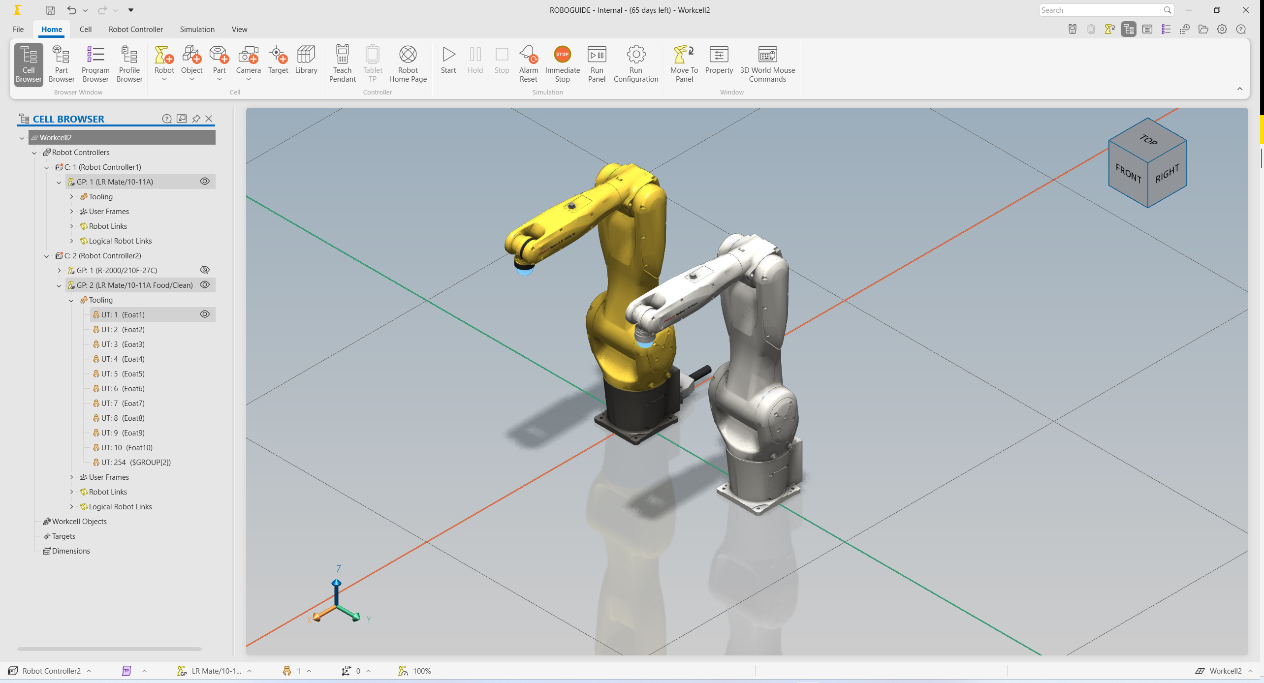

UI Changes: Ribbon Menu, Dockable Windows, Drag-And-Drop Robot Setup
ROBOGUIDE V10 introduces a categorized ribbon-style menu that is familiar to anyone who uses modern office software. Commands group by function, which reduces time spent hunting through nested menus. Dialog windows float or dock based on user preference, so engineers can clear the screen and focus on the 3D workcell. A cleaner view leads to better decisions, plain and simple.
Robot setup moves faster with drag-and-drop definition. Users select a robot model and place it directly into the cell without stepping through a maze of configuration screens. Motion types like circular, arc, and pass-through appear visually before the program runs, which gives instant feedback on path intent.
Virtual pendants display simultaneously for each controller in the cell. Focused browsers for robots, workcell objects, parts, programs, and profiles keep navigation organized. A structured ROBOGUIDE tutorial often starts here, since the interface shapes how teams experience ROBOGUIDE software from day one.
ROBOGUIDE V10 New Menu UI
ROBOGUIDE V10 menu UI

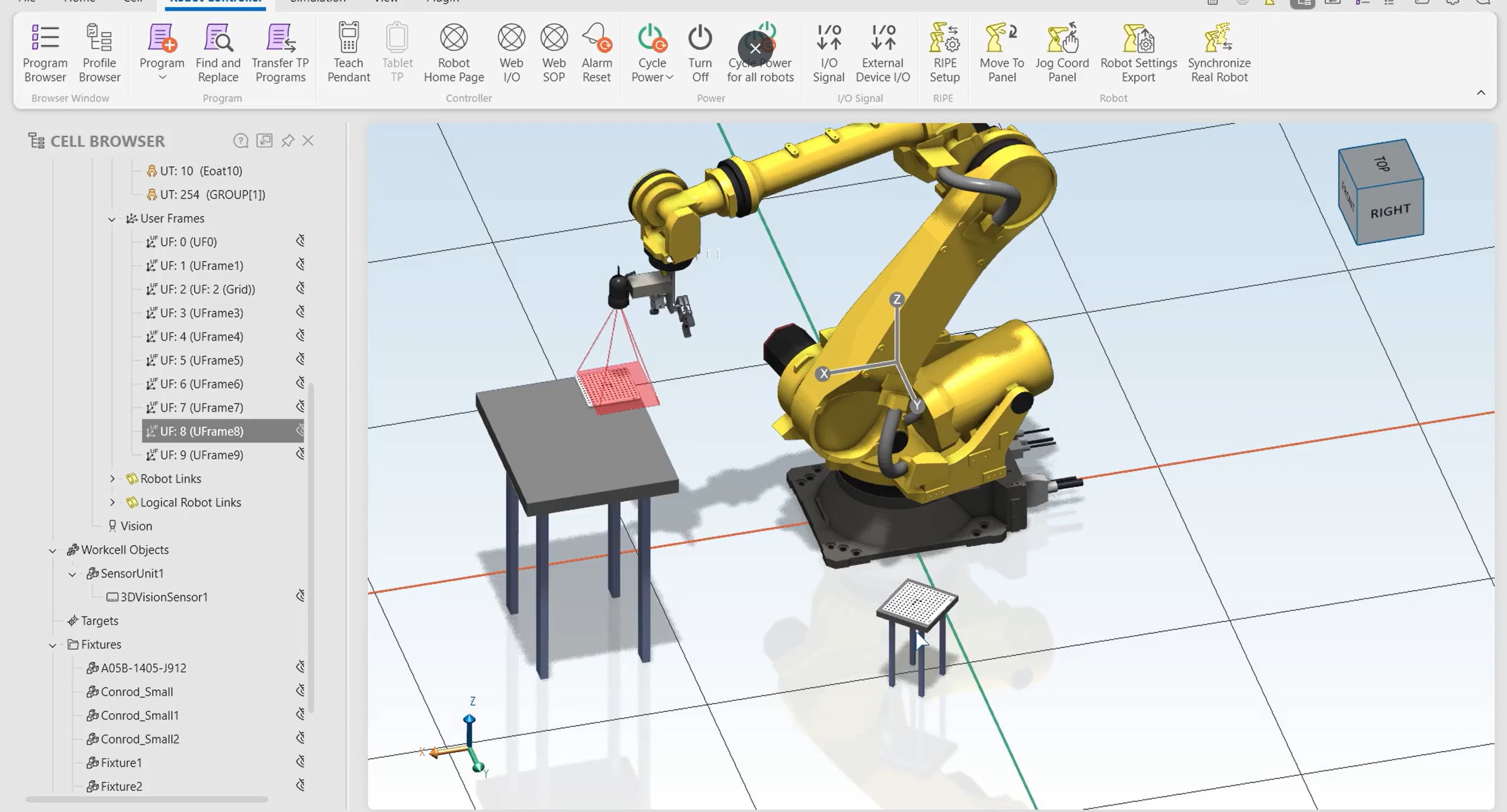

A Plain-English ROBOGUIDE Tutorial Path: Build A Cell, Prove A Cycle, Export A Plan
Here’s how most engineers actually use ROBOGUIDE V10.
  • Start a new workcell. Select the controller type and define the basic environment. Set the floor reference, drop in guarding, and build the cell layout to match the real footprint.
  • Pick the robot model and software version that match the planned installation. Controller options, motion groups, and payload limits shape everything downstream.
  • Add EOAT and fixtures. Import CAD for grippers, vises, or conveyors. Define tool frames and user frames carefully.
  • Teach motion next. Create approach points, process points, and exit paths. Review cycle time outputs and check joint travel. Record playback and watch for awkward wrist rotation or tight clearance.
FANUC’s free robot tutorial website Tech Transfer offers ROBOGUIDE V10 pick-and-place videos, new feature walkthroughs, and highlight overviews that unlock a deep library of engineer-led tutorials supporting daily use.
ROBOGUIDE V10 with iRVision EOAT
End of arm tooling in ROBOGUIDE V10
