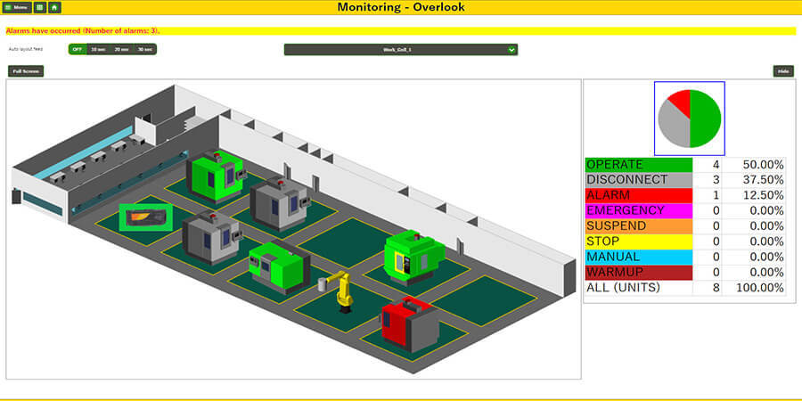

MT-Link-i is a comprehensive software package offering users the ability to do a deep dive into the analytics. For those who are a little further along in their digital transformation and looking at collecting and analyzing a sizeable amount of data, this is a perfect solution for you.
Users are able to view a snapshot of their operations from any web browser: PC, tablet device or conveniently placed monitor. The software provides a color-coded visual representation of the floor, so each machine’s up-to-date status can be easily seen.
“The majority of manufacturers are looking for a solution to solve their low-hanging-fruit production problems.”
With this real-time critical performance data as well as the ability to pull up past issues, you can quickly see problems happening and understand your equipment’s performance. Additionally, you can track trends and have the tools necessary to help prevent unplanned downtime.
Also, you’ll be able to get immediate return on investment with the ability to automatically backup and archive important files, including part programs, tool offsets, parameters, operator history and more, all while the machines are in production.
Moreover, you’ll be able to easily connect to FANUC CNCs and robots or any other non-FANUC CNC, PLC or other devices via MT-Connect or OPC-UA protocol.
