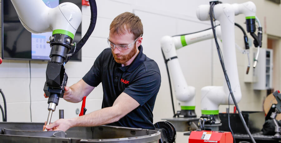

Hand guiding is simply defined as having equipment, such as a hand guiding handle, positioned near the robot tool or end-effector. This equipment includes both an emergency stop and an enabling device, similar to a live-man switch found on a teach pendant. Many automation users view hand guidance simply as lead through teach, which is the ability to move the robot freely to teach points or paths in the operation. This opinion is fairly common, but teaching by demonstration is just the beginning among the many areas that could benefit from using hand guidance techniques.
A frequent opinion is that hand guidance applications face limitations when dealing with longer reaches or heavier payloads. This is because there are only a few large cobots on the market. It's true that most power and force-limited collaborative robots may not be suited for very large tasks. However, it's essential to recognize that the majority of robots can be used in collaborative scenarios.
At the core of collaborative robots or collaborative operation is “collaboration”- to work jointly with others. Collaboration with a robot is frequently thought of as working hand-in-hand with the robot to complete a task. Hand guiding essentially involves an operator using their hand to lead or move the robot, representing a type of collaborative operation that truly embodies the essence of teamwork.
Remember that the best way to use collaborative robots is to have them and the operator work together only when needed, while each handles their own tasks in separate areas. It’s not much different when sharing a work station with another person. When integrating tools to assist operators, the devices should increase efficiency and decrease stress or strain. If you're always reaching or moving around your partner, whether they're a person or a robot, it makes the whole process less efficient.
It is important to examine the task carefully and consider the solution you want. This will help you find the best collaborative robot for your needs. In part 3 of this article, we’ll review a few collaborative applications for both small and large companies.
Part 2 – Hand Guiding - Flexibility and Functionality
According to section 5.10.3 of the RIA 15.06-2012 safety standards, hand guiding equipment needs to have an e-stop and enabling switch. However, in cases where hand guiding is used on a robot that meets the requirements of power and force limiting collaborative operation, the e-stop and enabling switch may not be necessary.
For these reasons, it really helps when there are multiple hand guiding options. FANUC offers two types of hand guidance handles, one includes the necessary integral safety for standard robots, and the other is wireless and works with the CR series of power and force limiting robots.
A product with many functional options is similar to a well-equipped toolbox—though you might not use every tool constantly, having them available can assist users in overcoming obstacles efficiently when needed.
The FANUC hand guiding product has a variety of built-in features, or tools for teaching-based applications. The hand guidance software is configured to teach paths or points, and a simple push button triggers the action.
What is point based teaching? In point-based teaching, the user guides the robot using the hand control to a specific spot and then presses a button to save that position. The user continues to guide the robot to the next position and records the point. Repeating this process can quickly generate a complete motion program for the entire application. Point based teaching is an intuitive process that’s especially easy for those who have never used or programmed a robot.
What is path based teaching? For some processes, recording the robot’s complete path motion is required. This method applies to applications like sanding or polishing over a complex contour surface when it’s essential to have a smooth path that follows a shape. Hand guiding software automatically records the robot's positions during movement.
It then replicates the entire path with accuracy. The operator simply presses and holds the teaching button and then moves the robot along the path. As the robot moves, positions are generated at preset intervals. Once the motion is complete and the button is released, the path is generated in the program. If fine tuning is needed, each position can be individually modified to achieve the perfect path.
Another great feature of the hand guiding handle is a button to control the tooling. Each press of the button will toggle the state of the tool. This is especially useful in robotic applications where an operator needs to move a part from one location to another. There are programs that can restrict the gripper's operation at the pick-up or drop-off points. This ensures the operator does not accidentally release the item outside the designated areas.
Some applications might require slower, more precise robot motion in critical areas. A button is included that can automatically change the motion of the robot under hand guidance control to a slower speed for better control of the robot’s position.
In other situations, it may be best to limit the robot’s motion to only linear movement, not allowing rotation of the tool. A button is included to switch the motion profile from rotational articulation to only linear motion.
The more extensive wired hand guiding device features an extra button. This button is used to program applications that need maximum process control and flexibility, like multistage operations. It's also useful when local safety rules demand that the robot be operated with both hands.
This extra button shows that the hand guidance part of the application is finished. It lets the robot go back to working on its own when safety rules are followed, like when the operator leaves the area. Depending on your application, you may not need all of the tools available with FANUC’s hand guiding product, but each feature is built in and ready at a moment’s notice.
