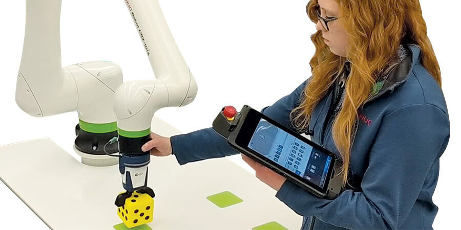

4. Hand Guiding cobots
Finally, hand-guiding cobots have a safety-rated device attached to the end of the robot’s arm to allow a person to guide or move the robot around manually.  Hand guidance is often used to quickly and easily program new robot paths and positions by hand. It’s ideal for mobile applications where the cobots move between stations and require re-training to accomplish different tasks, and when the cobot needs to be reprogrammed frequently for a new job.
