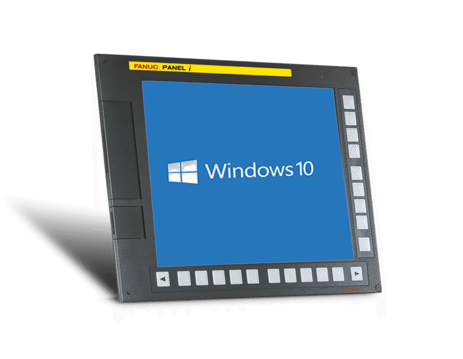

Komo has been retrofitting industrial PCs on machine tools for a few years now, on average, about 15 annually. However, Pardi says there are a lot more machines out there in need of upgrades, which is why FANUC is working with the industry to provide a new Panel i Replacement Program.
“We estimate about 300-350 of our machines eligible for an upgrade are still in use with outdated operating systems,” he says. “Even some that already upgraded to Windows 7 a few years ago are upgrading to Windows 10.”
The increased security of Windows 10 IoT Enterprise operating system is one reason to upgrade, but the new OS also unlocks a large number of commercial applications and allows custom software applications to be developed.
